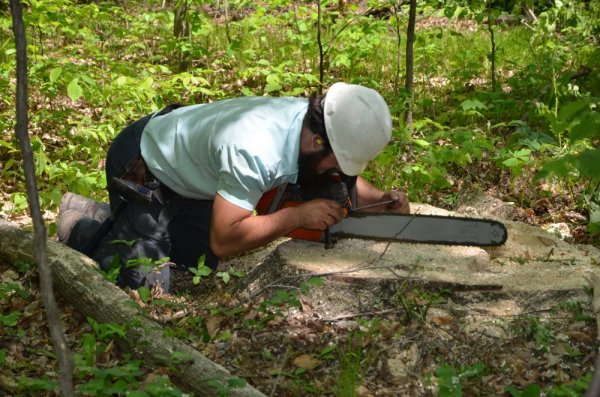

    I had hired this Mennonite gentleman to help me timber out 120 big trees. The stump gives you an idea of their size, about 30 of them were well over 3' diameters. He cut them all with his 24" Husky, sharpening just by hand, with just a file with no guide. This saw was cutting through those trees like butter throwing big chips all the time. He would stop after about every 3 trees were dropped and cut to logs to resharpen. He would position himself as in the photo with a lot of force on the saw to stabilize it (hurt my chest and neck watching him) and just give 2-3 very slow, light, controlled strokes on each tooth. That was it, and off he went ripping into another tree. I thought if he can do this, I can do it, maybe even better!
    I started by stabilizing my saw's bar, in a vise as others have said, only way to do it. I clamp it right on the middle of the bar and crank it down tight. (I used to try to hold the bar down with my left hand and file with the right hand, isn't going to work, you need that bar tight and 2 hands to file).
    Next, I use the flat guide on the file to help align my angles and maintain my file depth. He's doing it all by sight and feel, but I have no doubt that the guide gives more precise consistent results. He's also filing straight across the tooth as opposed to the slight upward angle. He explained that since the tooth will "tilt" over slightly when stroked, you are actually giving it a slight angle holding flat ............ I agree with that and hold level too.
    Then, the most important part, and difference from what I had been doing, the stroke. I know that a file only cuts one way, but I still used to do more of a "sawing" action backing off the tooth on the return stroke, and applying force on the cutting stroke. This still caused the file to occasionally drag lightly on the tooth on the return. Like him, I now use a slow, light, 2 handed controlled stroke, then lift the file out on the return. I'm amazed at how much metal you can remove with just a few light strokes of a sharp file. Here is where the "feel" comes in. You should feel maximum resistance when you have the tooth totally cut as the largest fresh surface area is now exposed.
    He also didn't aggressively take his rakers down, maybe just a smidgen more than normal.
