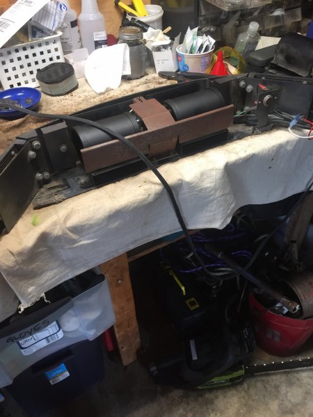

    Pulled the unit and took the shroud off and ran it.
    Definetly sounds like it’s coming from the drive unit and not a fan.
    It’s had 8 years of duty running continuous for 5 months a year. It’s probably it’s time.
    As a side, if you find it not as easy as it should be to pull the thing, try a couple wedges in the back to take some moment off the clips

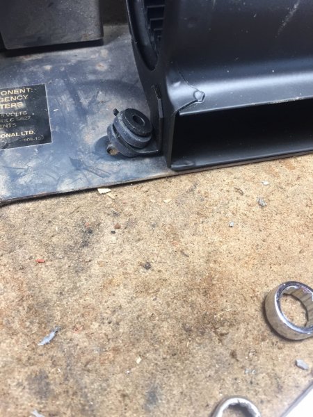

    Minor issue with one of the hold down feet that just needed some bending back.

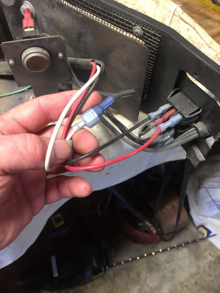

    There was no place for the ground on the new unit, so I had to drill a hole.
    Wiring instructions were easy but opposite the current blower. Red to low speed. Black to high speed. I tried it both ways and seemed fine. Neutral went back where it was.

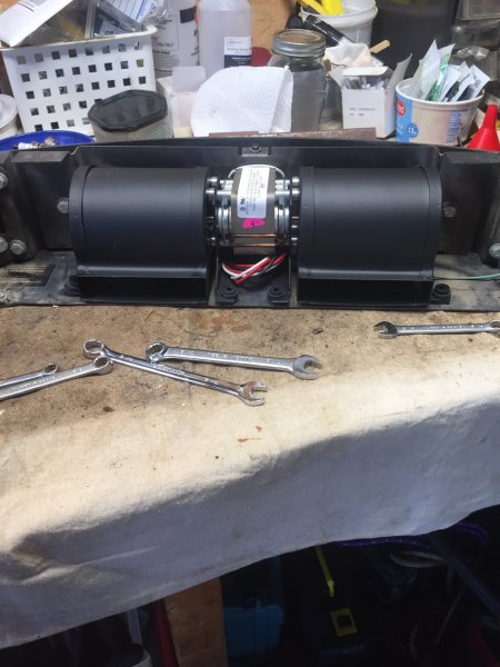

    It fit perfect. Pretty easy job.
    The high seems to not move as much air as the old unit. I’ll wait until we need to use before passing judgement
