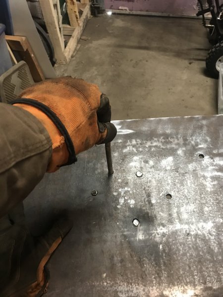

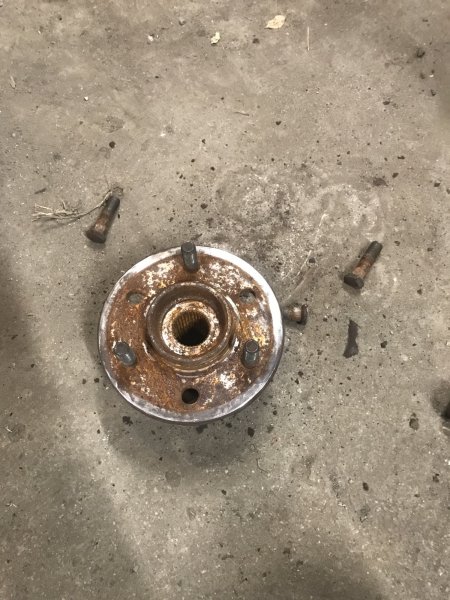

    First pounded out 3 lugs that arent needed.
    Then drilled and fited the hub which took a little flap disc work but it came together nice.

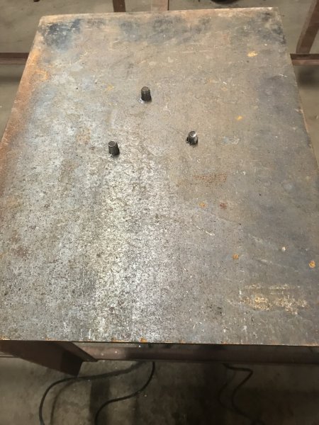

    After it was attached I cut the studs off so I could weld them in. and drilled another hole that utilizes the eye used for mounting the hub to a vehicle as well as one of the stud holes I knocked out of the hub earlier for a pin to hold the table in place.

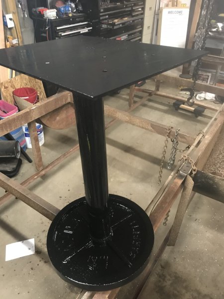

    Got home early and found a rusty old can of black enamel in my messy garage fridge and it’s still in excellent shape. Heated the paint up with a torch mixed it up and slapped it on. Doesn’t look to bad!
    Probably take 2 months to dry in these temps unless we get a good sunny day so I can set it outside!
