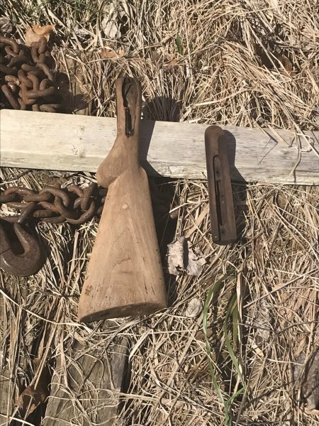

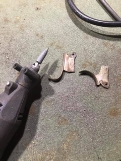

    bought an A. Greener Belgium made shotgun at auction. The lightning isn’t great but the blue is gone, so just needed to polish a bit

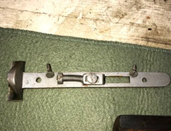

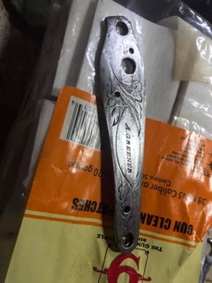

    I plan to cut the barrel down to a coach gun. It has some nice engraving, and the stock checking is strong. From looking at the gun upon tear down, it seems to have been shot a lot. Lots of wear on right sight parts. 2C122A66-8DD6-4E91-986B-013D80D1AAFA.jpeg

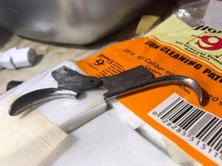

    Gorgeous day, but as the sun dropped I went out to tinker some more. HolsatiaRedneck keep munching the popcorn!

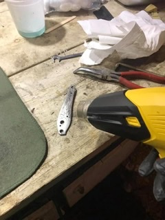

    AC6A6E6F-F429-4899-B48C-4B3852B3F079.jpeg A7FE7F3D-AAE0-4331-9299-FF019B34E95F.jpeg BA4556E9-706A-44F4-9FF1-0A07F4EA5039.jpeg Polishing the triggers and putting a little heat on the hammer spring plate.

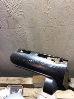

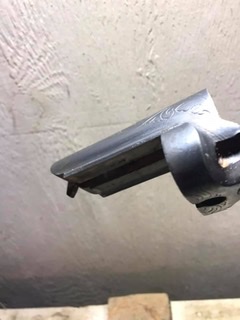

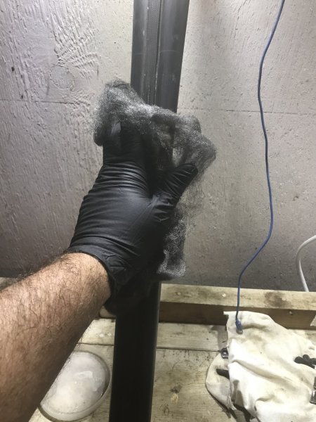

    First coat on the plate. Final coat on the main part. I think I stopped at five treatments
    9F8B4F8F-BDEC-4EDF-8719-124E46259BCF.jpeg 1101FBF9-3A8C-4465-95AA-7DF2683DB162.jpeg 98E2E200-58D4-4870-BF6B-DE62442EDC59.jpeg

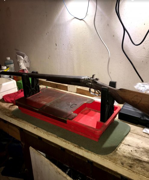

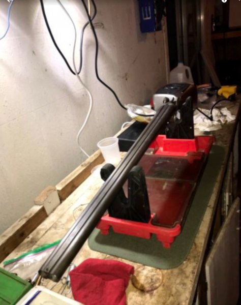

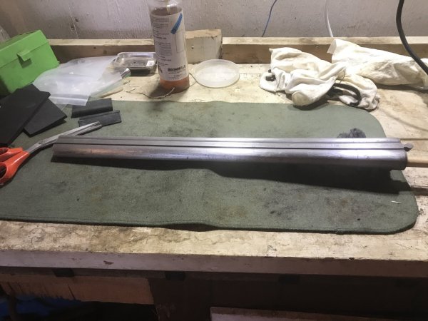

    Got bored and cut down the barrel so the blue process could be done.
    27127673-B4EB-4DFD-B513-759BE942BB64.jpeg 450E6828-C072-444E-89AF-C6D9C669260A.jpeg DB878FCA-C34D-4F4D-813C-296D3BB3068A.jpeg

    finished barrel with a heavy spray of oil.

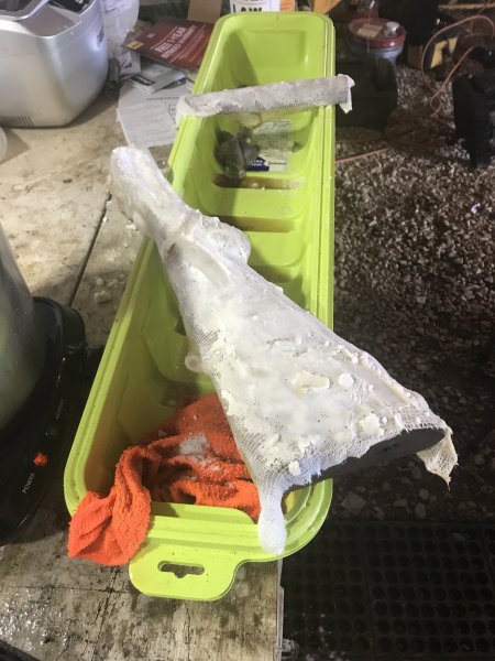

    Next was too prep the wood elements of the gun. Very hot water and Krud cutter and brushing to raise the old oils. Wrap in cheesecloth with mor Jrud and sprinkle on some baking soda. Finish off with another brushing.
    After it dried a couple hours it seemed to have removed the oils and varnish without harsh chemicals.
    Next is to coat with either boiled linseed oil or go with gun stock stain and Tru oil
