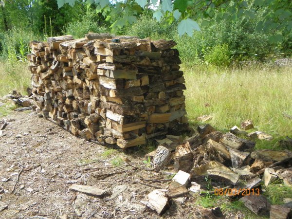

    You better just give all that old wood away that you have stacked Sav.....it's way too dry and we don't want to see you warp your stove.

    Do you mean this stuff Locust? It was cut to length about 14 or 15 years ago and just laid on the ground all that time. There are 3 rows there and we did burn 2 of those rows this winter. This is perhaps the oldest wood we've ever burned, and it is all red and white oak. Sweet!
