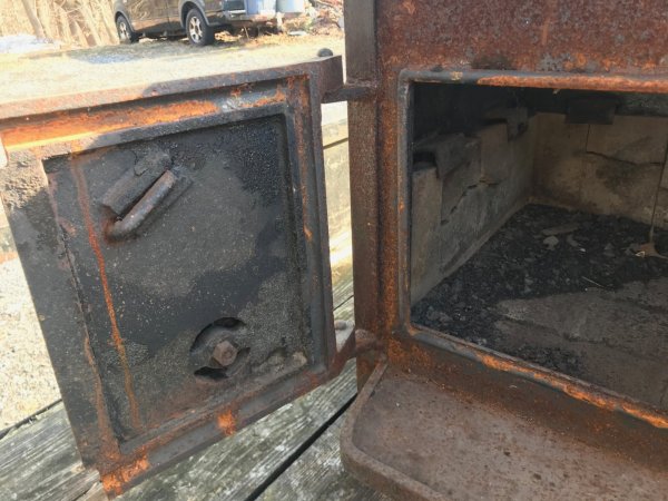

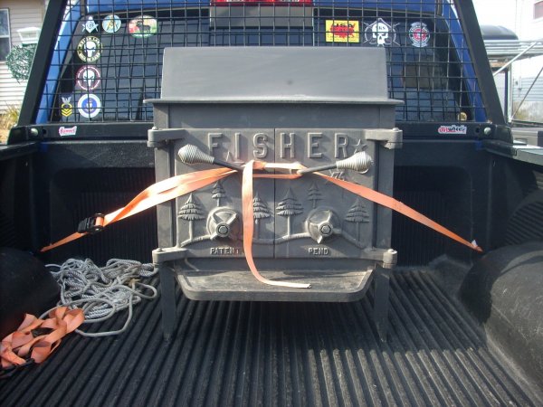

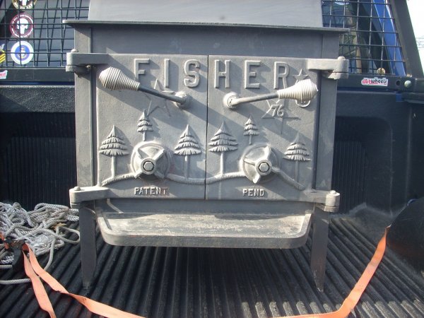

    Picked up my Christmas presents today.
    Grandma
    And Grandpa
    Happier than a pig in @#$%. :pete: Thanks, but I already cracked a cold Premium.

    Grandpa going in the basement after refurbish and adding a baffle.
    Grandma going in the Oak Hill Saloon after refurbish and adding a baffle.

    The bi-centennial -1976 is the GrandPa stove, specs are;
    Requires 6 bricks across back, 4 sides
    Flue size 8 inch top or rear
    The Grandpa Bear was the largest at the time, only one other Fisher model, the XL was ever made larger. Grandpa measures 29 1/2 inches across the top plate, with the box measuring 28" wide X 23" deep. Comfortable heating 2000 s.f. as suggested in Fisher literature, the stove is capable of even more.
    The first stoves had stars on the doors, and a 76 in the largest star on the right door. Like all other Fisher Stoves with solid cast iron doors, they do not use gasket material for a door seal.

    The pictures I posted are of a GrandPa not a 76 and a GrandMa which is a 76

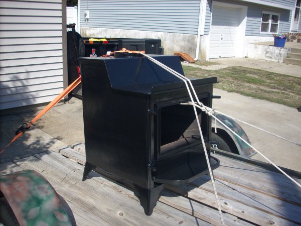

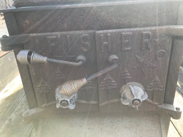

    Forgot I had this pic
    You can see both on the trailer.

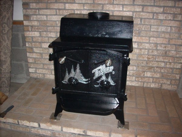

    Welcome aboard PA Mountain Man . I've Made baffles for 4 of my stoves and have some pics in this forum somewhere. Coaly is in the NEPA Vally and has had Fishers for 50 years. I currently have 3 but restored and had 12 at one time. New Spring handles are available and throw out the firebrick and replace with new. As long as there are no cracks anywhere, they'll be fine. Just take your time and work on them. I refurbished my Grandma I'm burning now about 5 years ago and it's been in this house since about 1980's :yes: Keep us posted, I would like to see the progress.

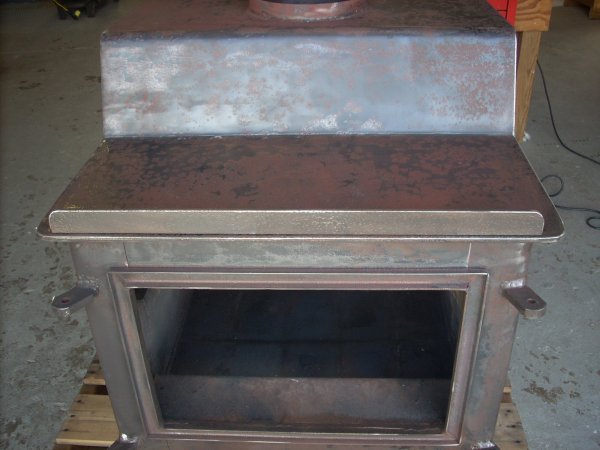

    Neither stove has visible cracks, and when I do the walnut blasting I will be able to do a better inspection.
    I will post pictures as I make progress.

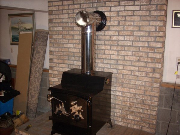

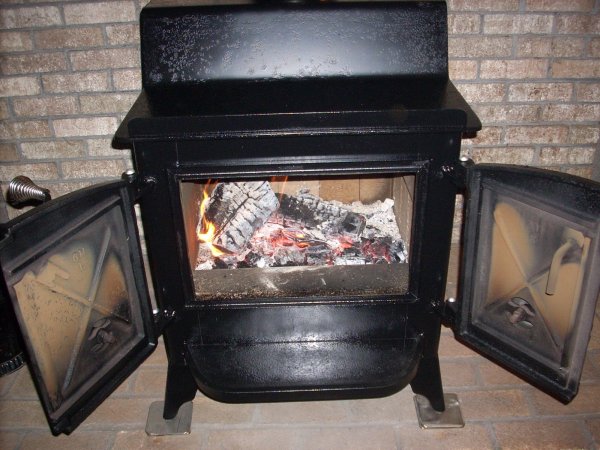

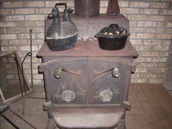

  14. WeldrDave
    9,278
    48,415

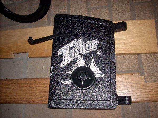

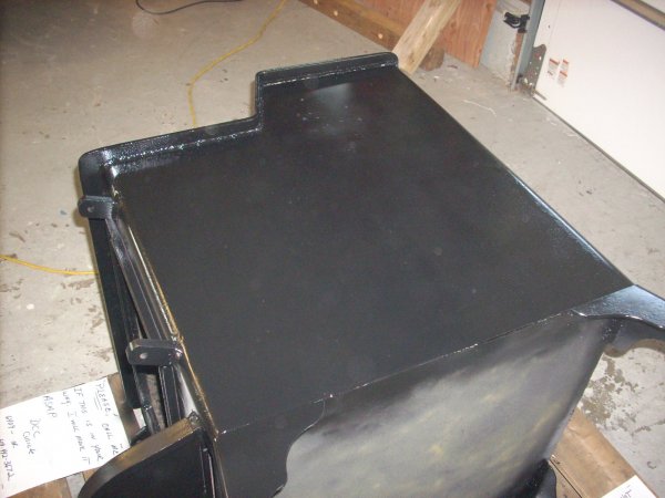

    Some before and after of my 1980 Grandma DSCN2118.JPG DSCN2122.JPG DSCN2139.JPG DSCN2159.JPG DSCN2163.JPG DSCN2172.JPG DSCN2169.JPG DSCN2179.JPG DSCN2176.JPG DSCN2190.JPG DSCN2193.JPG
  15. WeldrDave
    9,278
    48,415
    I did not blast this stove, I only had a couple big "wire cups" that fit on a grinder. I did acid bath it after, (not seen) and painted. I also "pre-burned" it outside slow to cure paint and not smell up house! :eek: I have several more stoves and pics. This was the last one and I knew what card they were on. :whistle::rofl: :lol:

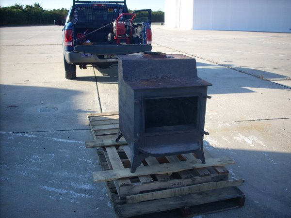

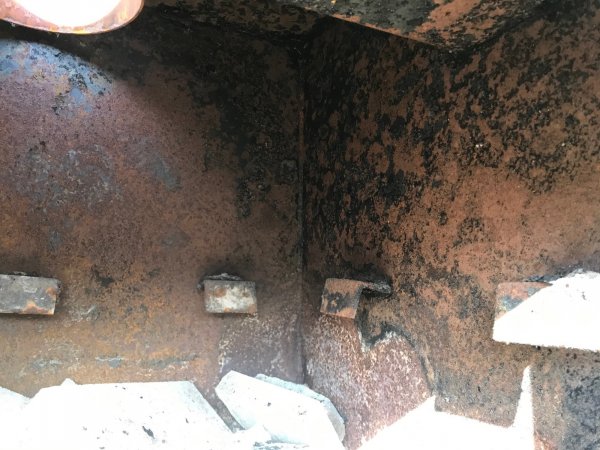

  16. WeldrDave
    9,278
    48,415

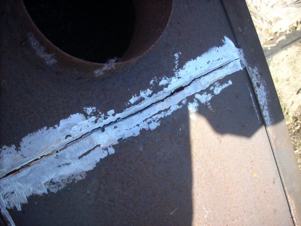

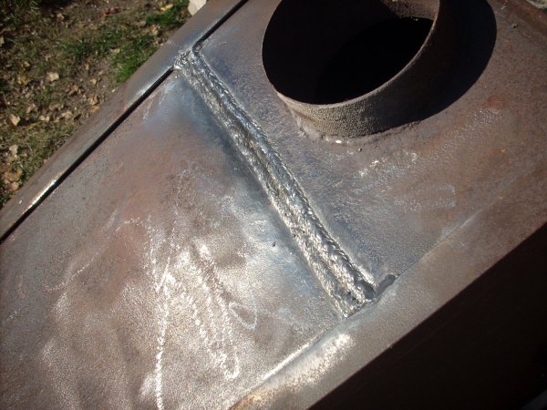

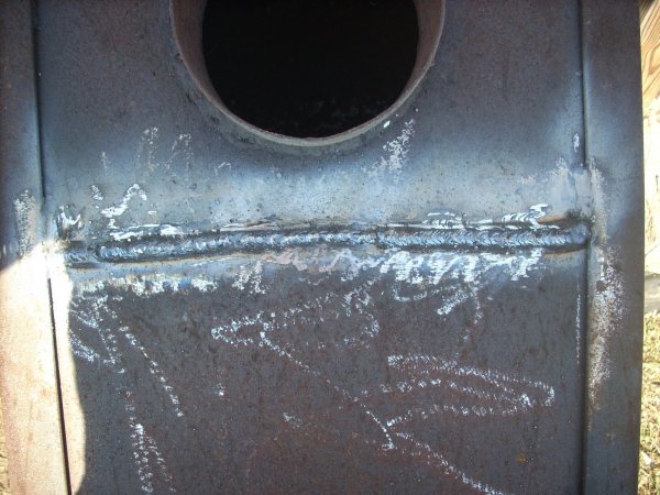

    When I spoke of cracks, here's a Mama bear with a crack at the weld seam I had to fix. It was poorly welded originally and the plate warped, I finally got it straight, (not perfect). Also, there's a pic of my Bicentennial Grandma. $300.00 and a 2hour drive. DSCN2774.JPG DSCN2791.JPG DSCN2795.JPG DSCN2801.JPG DSCN2803.JPG
