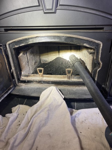

    So I had someone out to clean the chimney for me. I next year I probably won’t try to sneak in the wet uglies when my supply runs low. Better to pay for some gas heat then to clog up the chimney. D701FC47-91D9-4011-8996-1EF3DB056FB6.jpeg

    Nice pile of black stuff. Cause and effect.

    Any one try burning the creosote once it is in the stove? There has got to be some btu’s there if it could cause a chimney fire, right?

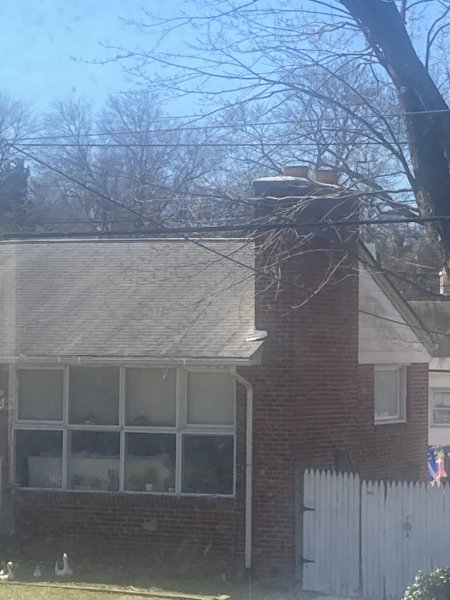

    Couldn’t tell you how tall, but generally plenty of draft. Similar to the neighbor’s as pictured. I had it cleaned in the fall.
