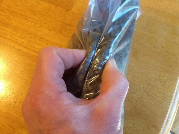

    For my stove, Englander specifies high density gasket. When I went to the local store to get some and asked for high density, they didn't seem to know what I was talking about, I bought some anyway and it lasted about a year, so I got some oem from Englander, here they are side by side both brand new, same dimension specs just different densities.
