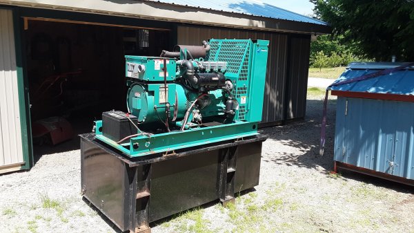

    20kw and sitting on a 200 gallon fuel tank, but it needs a building.
    My meter and transfer switch is about 100' away from our building so for convenience and noise concerns, that's where it's going. It's 10' wide x 9' deep for plenty of room to access any side of the generator.

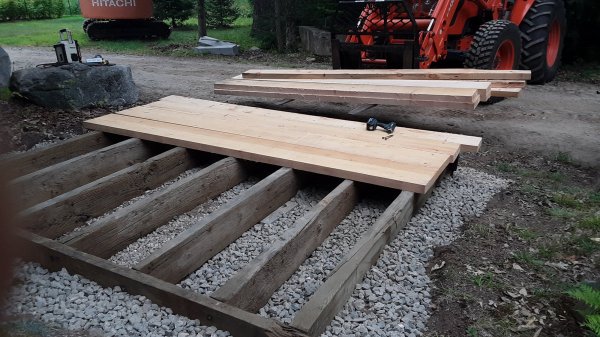

    Here's the "foundation". 4x10 pt timbers scrounged from a ferry boat pier deck replacement. It's sitting on an excavated 2' gravel bed on well drained soils, again for simplicity and costs.
    I cut these for the floor, 2 1/2" thick.

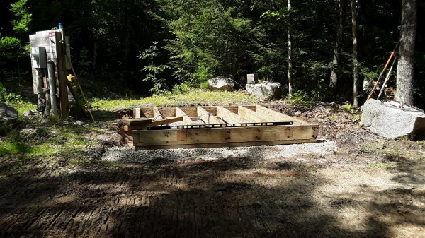

    That's moving along quickly.

    4x10 joists and 2.5" thick flooring. That's not a generator building, its an amory!!!
    Nice job, looks great!!!

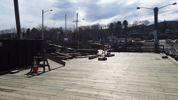

    I did the math, converted the cu/ft to gallons, then found the weight of #2 fuel and estimated the genny's weight. Figured that it's easier to over do it instead of re-doing it. The joists, heck, it's what I had (scrounged) but it was a 100 mile trip each way but a beautiful ride to the Lincolnville ferry on the beautiful coast of Maine. I made 2 trips like this 20200415_092740.jpg
    and this is the portion that got replaced. That's the new deck.
    and a bonus view down the ramp. The ferry loads to the right. 20200414_154159.jpg
    It was mid April, just coming out of winter and just a fun change. Not to mention they were free. I had visions of garden box's raised up on legs at waist height but the planks are pretty rough on the traffic side, worn unevenly (in thickness) from one end to the other and in general pretty rugged looking. I mainly was interested in the treatment of the lumber. "Timbers", are not subject to the epa or whoever it is that screwed up the goo that they inject into what's called dimensional lumber ( 2x's etc) and subject to kids licking and knawing on it (I guess).

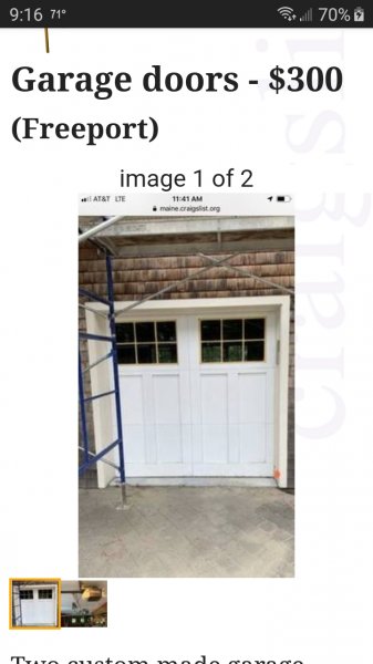

    I do make some good finds on Craigslist. Both generators and a bunch of other building supplies. In fact I was going to build the double doors so that the generator would fit through, but found some small (7'x7') very arttractive garage doors just yesterday,

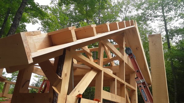

    Getting into the slower parts along with some other distractions. Not a lot to show but I'm trying to get to the point where I can confidently order the little bit of metal for the roof. The overhangs are time consuming, especially cutting my own lumber. 20200903_143634.jpg 20200903_143641.jpg 20200830_161310.jpg
    Some of those soffits boards are 14" wide and heavy, a real adventure in creativity putting them up by yourself.

    Great build so far! That's one serious generator shed
