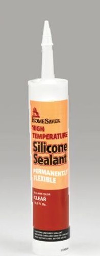

    HomeSaver High Temp silicone.
    Skier76, subsailor and imacman like this.

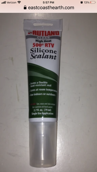

    The GC60 or M55 OEM gasket is 9/16” diameter and 10 feet long and expensive. The Standard Rutland 1/2” inch graphite impregnated gasket and tube of Rutland clear High temperature silicone should work fine. This tube of silicone is cheaper than a big cartridge with way more than you need. :)
    Skier76 likes this.
