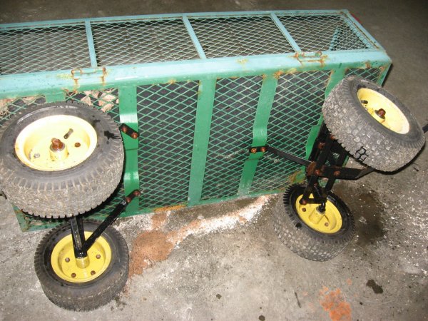

    these wont hold air is there something i can buy to put in them? they have tubes.........i dont wanna fall in love with this thing. IMG_0271.JPG

    fix a flat
  3. lukem
    11,828
    63,239
    Slime.
  4. HDRock
    17,249
    60,361
    I don't know what is the deal with these darn things, I have a buggy like that too.
    I put in new tubes on a couple of tires still had problems, filled them up with slime and I've been good since then.
    Just make sure you put enough in, if you go to the slime website they have a chart to tell you how much you need to put in what size tire.
    And be sure you get slime that says it is for tubes
    Or you can buy slime tubes already filled with slime to put in the tires
    SKEETER McCLUSKEY and rottiman like this.
  5. SKEETER McCLUSKEY
    SKEETER McCLUSKEY
    Aug 6, 2015
    12,546
    61,483
    Taconic Range
    thanks hd,im lookin at tubes since i posted this,think maybe ill get the plain tubes,not cause im cheap(im not) but i cant see puttin $60 plus labor in a $80 cart
