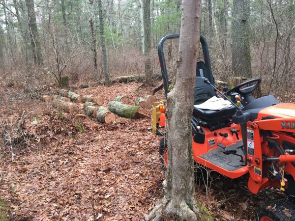

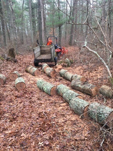

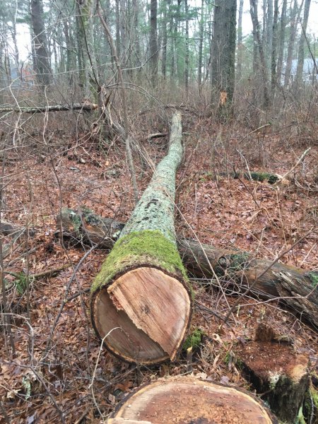

    Had two large oaks that lost their tops in one of the past wind storms so finally got after them today. I don’t usually cut any live oaks as I have more dead standing than I will ever get to. After processing these two I remember why and so does my back.

    Love the pictures. You have a very nice woodlot there!!

    Green red oak is some heavy stuff. Nice Winter day to be outside. Nice work there sir! :thumbs:

    Nice, you must have a lot of oaks, looks like the ground is covered with solid oak leafs.

    Nice straight sticks that weren’t too large to load. Doesn’t get much better. It’s a labor of love, no? :)
    After bringing home a couple trees like that from my old boss’s place, I severely regretted not noodling them in half. One of these days I’ll learn, hopefully before there’s an issue. Be safe, work smart not hard. :yes:

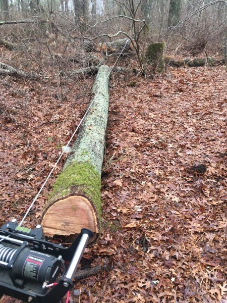

    Very cool you have a winch. Great looking rounds.

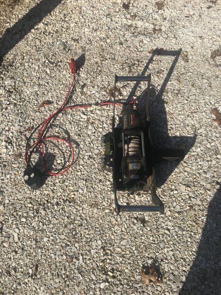

    Could you post a few photos of the winch setup you are using? I want a forestry winch but can't justify the cost, and I need something that is cheap and can easily attach to the 3-point hitch of my tractor. I was considering modifying a box blade for this purpose, basically welding on a secondary frame to mount an ATV winch, but yours looks like something you'd put in a receiver hitch?

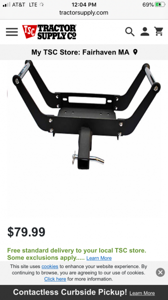

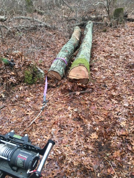

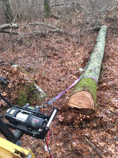

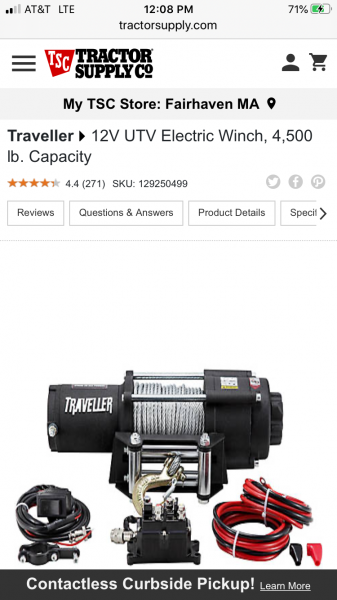

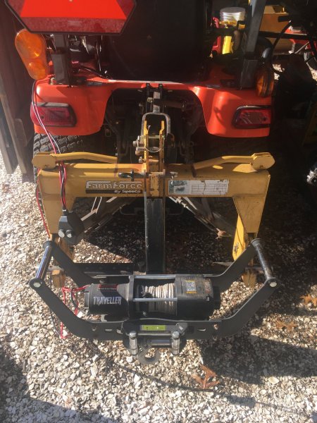

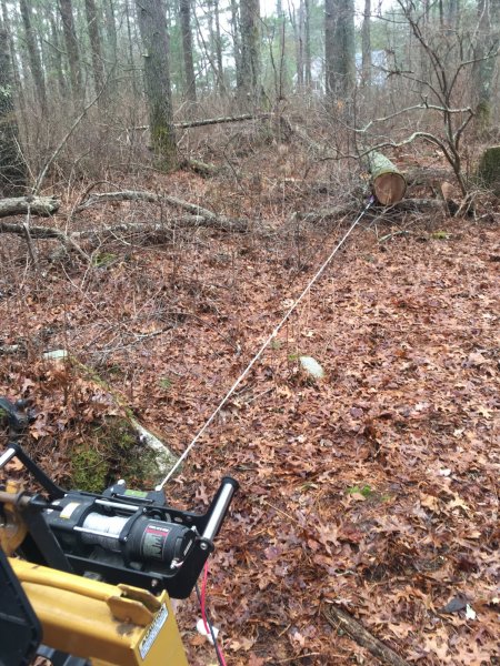

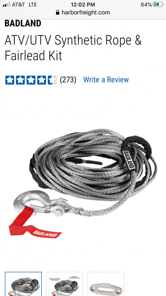

    Here is my receiver hitch winch set up. All from TSC but replaced the cable with HF winch rope as I don’t like working with the cable. Bought a back up rope incase it broke but have not needed it in 6 years I use it now to extend my reach to 100’ off the trail.
    make sure you get an ATV winch as they are set up to draw less amp and work better

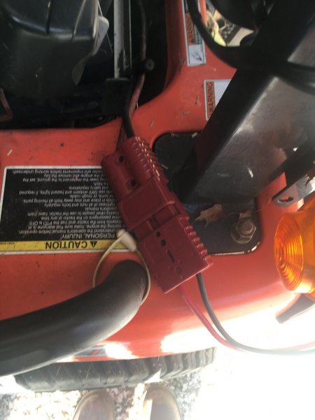

    And that's wired into your tractor's electrical system?

    Not really I went right to the battery.

    That's how every one I've ever seen is wired, either on my old broncoII, as well as all the ATVs I've seen and wired.
    Nice setup!
