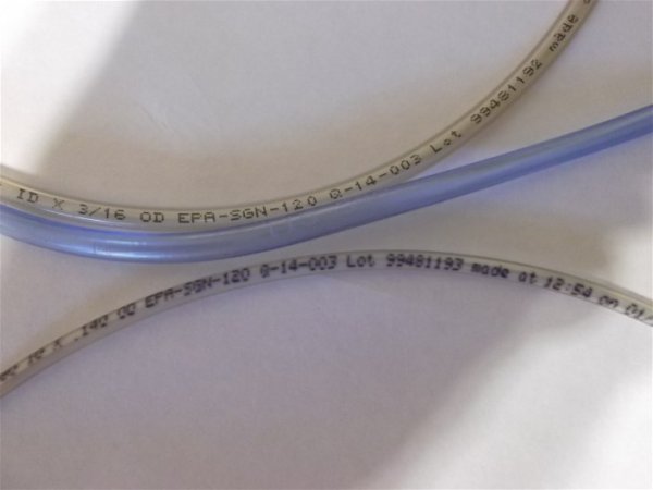

    I have 1100 in saws and trimmers. No replacements yet since installed. Have 1200 too not in anything yet.

    4040 is the origional yellow line
    1100LP is yellow but better ethanol resistance?
    1200LP is too stiff
    True Blue is not in 3/32-3/16 or 80/140 yet
    So back to the original question... Where do I get rubber echo line or some reasonable facsimile there of???

    Again in same thread. Nate is a Echo dealer and can get you echo line as already posted. My work is done here IMO.
