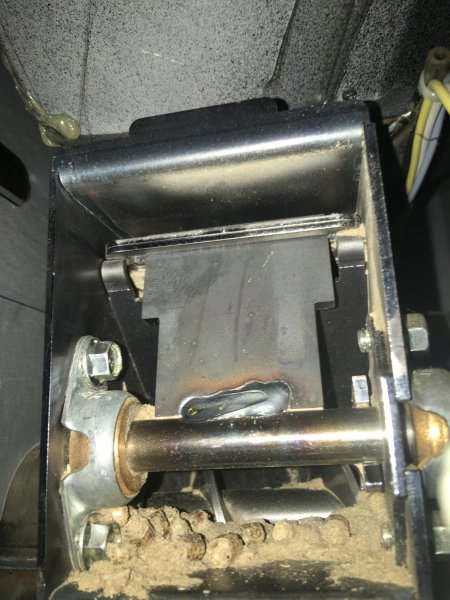

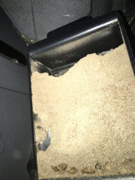

    The fines box is Not Fine if it is Full of Fines!
    Only Harmans have this but there are a few out there. The stove in the pics is a P61a used quite heavily for 2-3 years. :)
    Click on pics below to Enlarge.

    Every time I clean my P61A the fines box looks like that (I clean every 2-4 weeks). Doesn't seem to matter what I burn. Doesn't usually seem to affect performance when it is full though. Conversely, the P43 has almost no fines in there no matter what I burn.

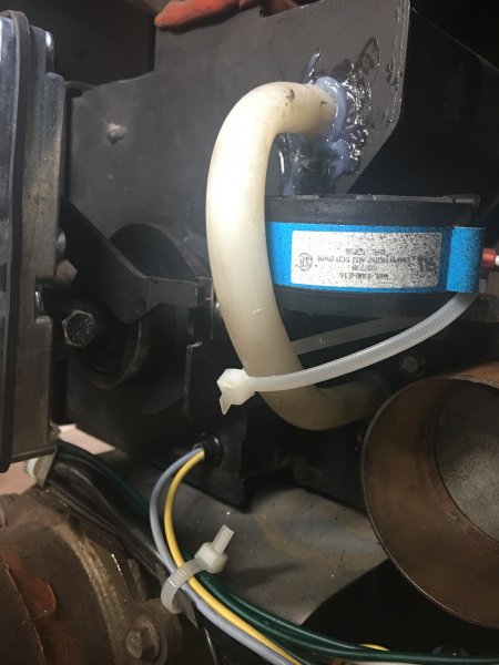

    This is a pic of a newer P61a that I installed about 4 years ago with the crossover air tube kit installed at the factory and has the steel fines box cover with the wing nut at the very bottom of the box.
    My much older P61s that have the cast iron fines box cover and do NOT have the crossover air tube kits are like your P43 and do not build up so quickly like this!
    So how old is your P61 BogieB and does it have the crossover air tube kit factory installed???
    Pic below shows crossover air tube

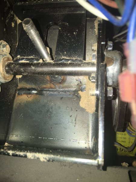

    Also my 10 year old P61 that has nothing on the bottom of the fines box.
    Can u take pics of your box?

    The fines box is part of the feeder weldment that contains the auger chute. The P61a is a bottom feed. The fines box also contains the slide plate and the arm that opens and closes the slide plate to limit the amount of pellets that drop into the auger chute to prevent auger jambs. Other bottom feed stoves such as the 25-PDV, 25-PDVC and the AGP have a top auger to limit the pellets into the bottom chute. Therefore the operation of this mechanism cause the fines to build up in there so there is a cleanout cover to remove the fines. The early cleanout covers were cast iron with a rubber seal. The new covers are Steel with foam Gaskets.
