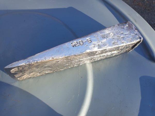

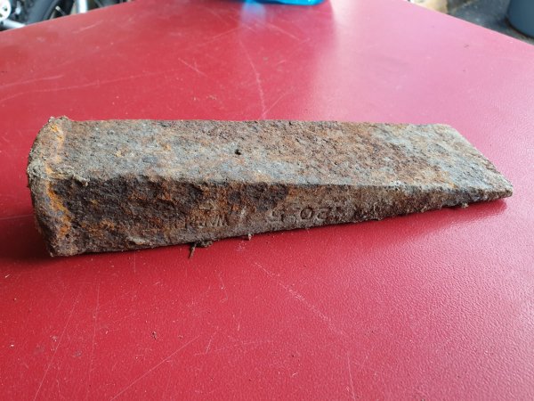

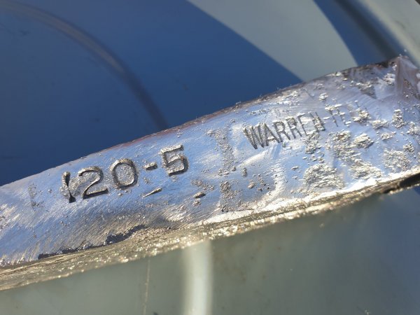

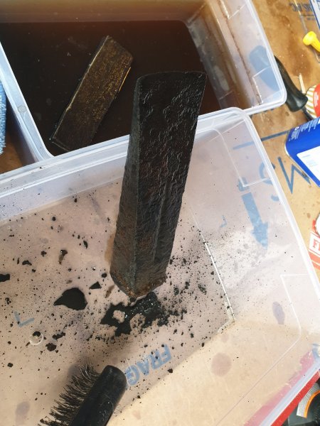

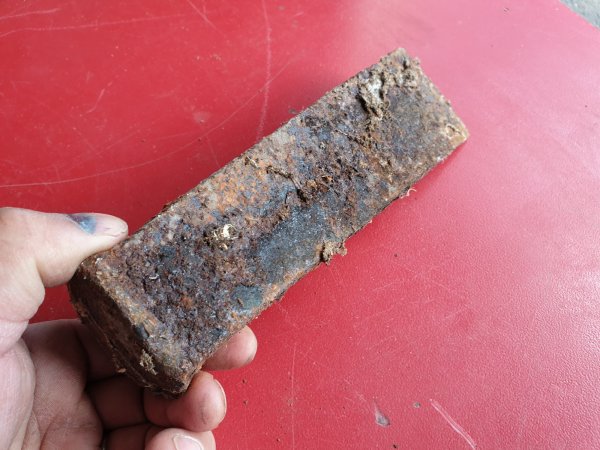

    Back in April of 2019 I found this wedge in my garage. I had just started splitting firewood....and watched a few videos......

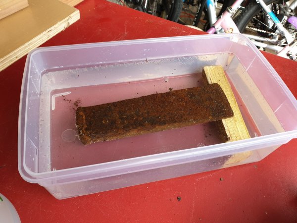

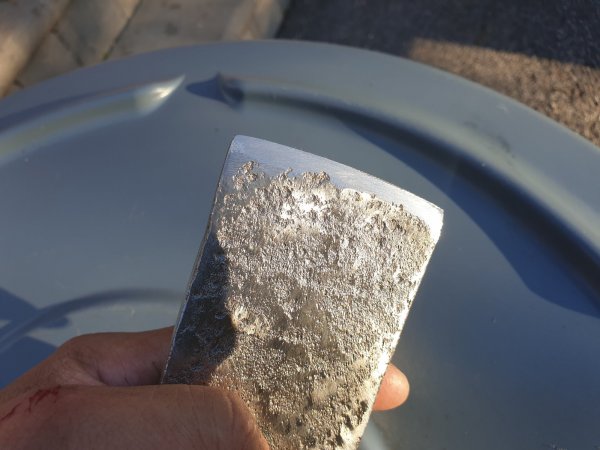

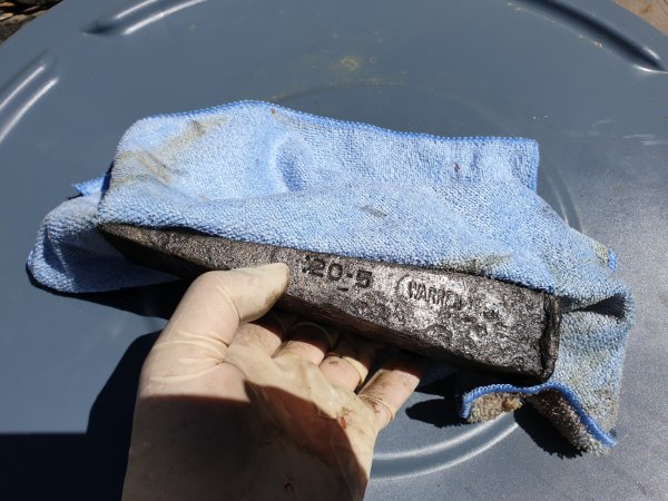

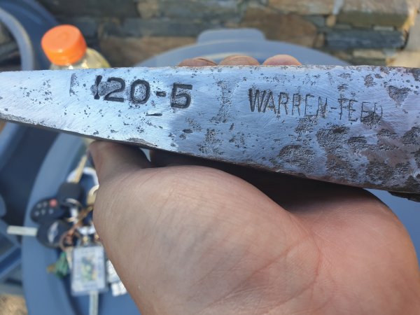

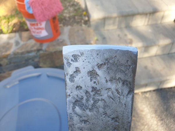

    Soaked it in vinegar for a week or so.......then wire brushed it clean using wd-40 as a lubricant and to prevent flash rusting. Put an edge on it with a bastard file and have been loving it ever since.
    I love the slim profile of these old school wedges. The new ones tend to pop out because the angle is to high.
    I got it so nice and shiny it looked like an ingot of silver!
    I thought it was a door wedge at first.

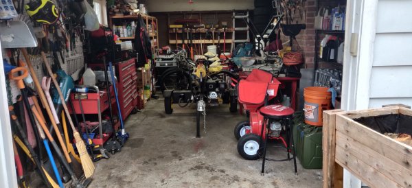

    I liked that one so much I bought another one on ebay for like $20. Worth it to have 2 of those bad boys. Recently had some HUGE 34" diameter x 14" height black oaks with some nasty knots in some of them buried deep inside that required both wedges. Combined with the isocore I usually win. I do, however, have some nasty beech that I will be saving for the hydraulic splitter. Just cleaned the garage today so I can actually walk now. Also have some knotty spruce that will be heading the splitters way.

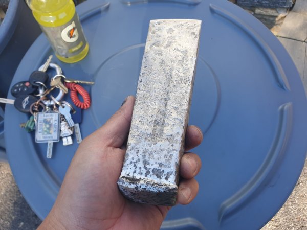

    Nice find. I am tempted to look for a couple, myself. One warning though: I know the mushrooming looks cool but you might want to clean that up for actual use, as the fragments are known for flying off during impact with the hammer, same for chisels. We were always cautioned in construction work, to keep our cold chisels, etc. clean and free of mushrooming. I guess as long as you are wearing safety glasses you would be pretty safe.

    Yep, I ground off the top of both wedges after I took the pics!
