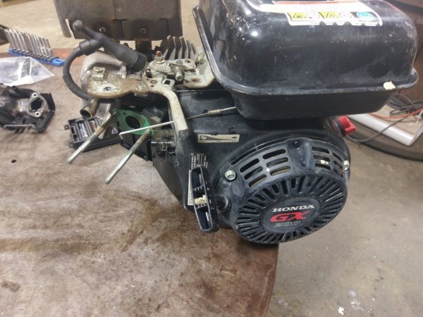

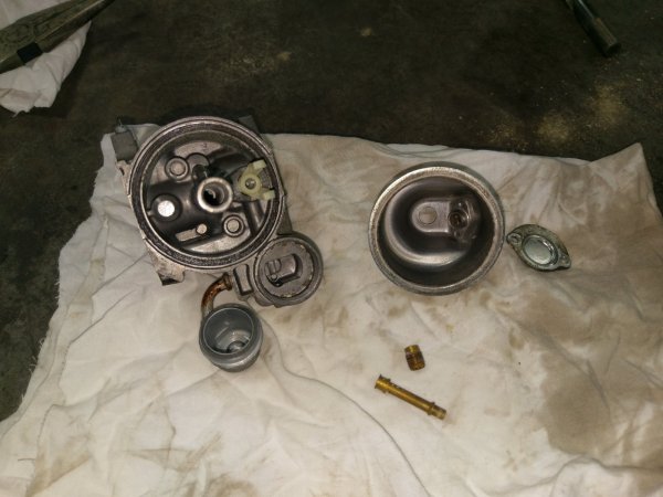

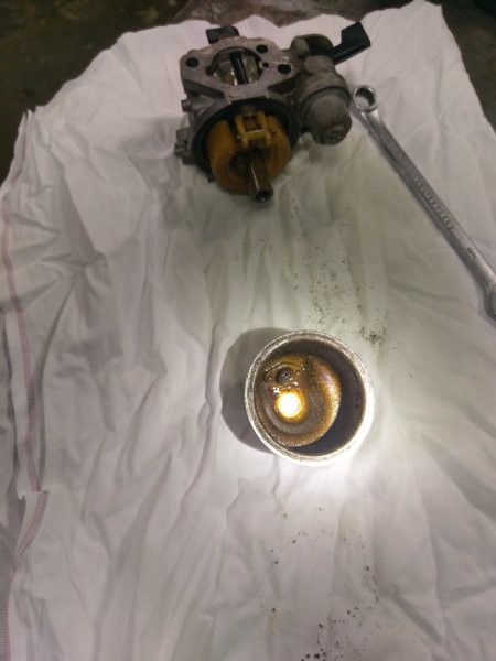

    OK, just snuck down to the shop and did a quick carb tear down. Replaced regular nylon starter rope with actual starter rope. Tore carb off, looking pretty nasty in there. I'll let it sit in the chemical dip overnight and see what happens. If I can't get it clean, I'll order a new carb for it. Shouldn't need much beyond that.
    The transplant.
    I would estimate that fuel has been sitting in here for about three years. Pretty bad, though the jets seemed to still be unclogged.

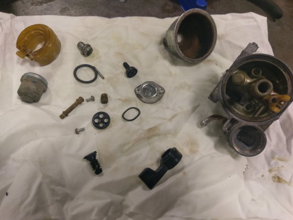

    Carburetor disassembled and parts ready to dip. Pilot jet, main jet, carb body itself, carb bowl, fuel valve bowl all go in.

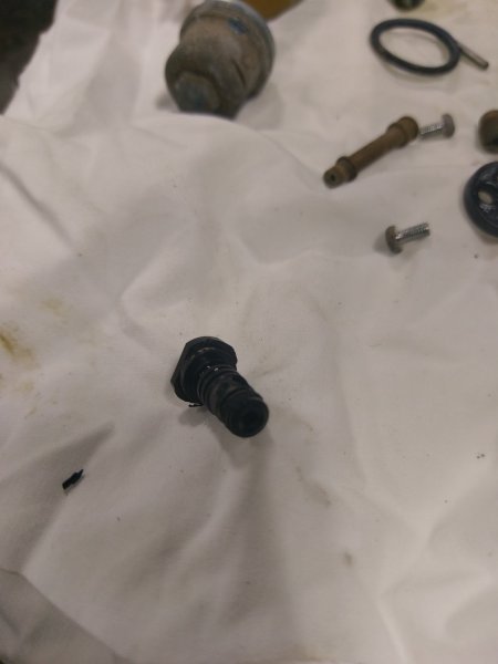

    If you ever have surging issues with a Honda, try clearing the port in this little guy. Found on top of carb underneath black plastic adjustment screw. I use a single wire on a wire brush to push through the orifice to make sure it's clear.

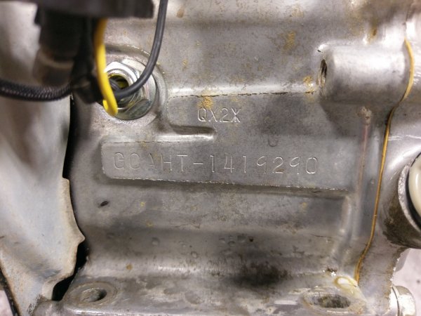

    Engine info. Stamped on every Honda GX engine, side of block. This gives all specifics of particular engine so correct parts can be ordered.
    More to come. Will reassemble tomorrow and see if she'll run for me. Stay tuned!

    24 hours in Berrymans Chem dip and voila! Cleaned up real nice. Sprayed brake clean through all ports followed by compressed air. Checked to make sure needle was sealing (open fuel valve and blow into fuel inlet while turning carb upside down) correctly after reassembly.
    Nice & clean!
    Reassembled and started on first pull! Has a slight surge at speed, but I'm betting that will come out after a little run time. Phone audio sounds bad, but she's purring like a kitten! Ready for duty!

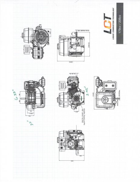

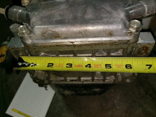

    Just need to polish up the crankshaft and it'll be ready to transplant. Now, I need to confirm mounting footprint and see if I need to drill any new holes in the mount plate on the splitter. This will likely happen this coming weekend.

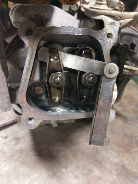

    Check valve clearance. Most of these small GXs will call for .006 intake and .008 for exhaust. These were just a little loose, but better than too tight.

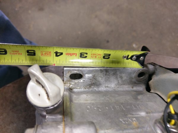

    Mounting dimensions.

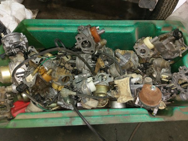

    Picture of Honda carb bone yard at work! Luckily I did not need anything from here.

    After finding a schematic, it looks like this should be a direct bolt on swap with no new holes or plate mods! :dancer:

    I think all the manufacturers do that on purpose. Universal bolt pattern. The holes on the predator I just mounted had one end oblong to account for variations.

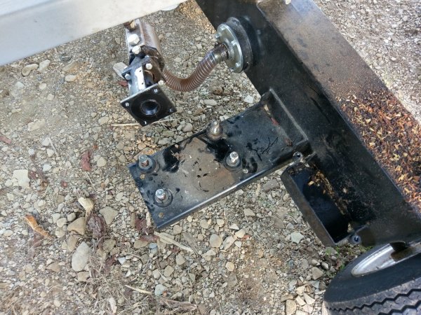

    Yep. It seems to be pretty universal and I think is classed by horsepower? There are actually two different sets of mount holes on my Forest King. The LCT and the Honda I'm using share the smaller pattern on the plate. The other set of holes are also larger in diameter. I did manage to yank the LCT off this evening after putting the battery back in the tractor. Probably wrap this up this weekend sometime.

    Job done. Fired it up and cycled a few times. Good to go!
