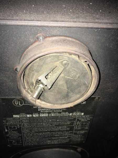

    This may be a dumb question but Since this site is a wealth of knowledge, I’m wondering if anyone knows what the purpose of this is on the back of my stove?
    874E9964-57F9-4184-B186-3404E0CCD98B.jpeg The small knob on there is moveable and can be set to keep the flap open or shut. When I first got the stove it would occasionally puff smoke out of it if I shut it down tight after getting a good fire going.

    Is that on the back of the stove outlet where the pipe goes...like I think it is? Looks like a barometric damper, but I don’t see how it can be if the stove pipe goes there. Shouldn’t be a barometric damper as they’re typically frowned on for wood stoves and it wouldn’t go inside the pipe anyway, not like that anyway.
    My neighbor has two of these and I’ve never noticed them in his stoves and he’s never mentioned it.
    Can you show us some additional pictures of the stove, not so close up?
    That looks like a barometric damper but I don’t see how it can be and have a stove pipe go over top of it. A baro is designed to fit into a pipe and still remain exposed so it can be adjusted as well as use room air as part of its function.
    Is the stove hooked to an exit pipe now? Shouldn’t be because everyone I’ve ever seen were rear exhaust like that with a blower fan below the pipe outlet.
    That is one strange photo. Take some more pics of the stove please.

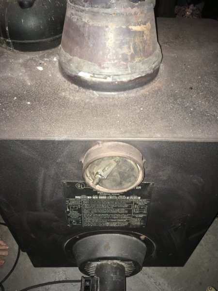

    Yep the actual stovepipe goes out the top, here’s a pic of the back from further back. Guess I’ve never heard of a barometric damper.

    91F6B8C3-E01A-46EC-965C-B899D7698461.jpeg 47429A9D-40C8-434D-B82B-33AAE4C922C3.jpeg

    Now that I think of it, I think I have seen some of these being top vent, but I don’t recall seeing the backs of the stoves and seeing one of those...and it does appear to be barometric damper, but I will refrain from calling it that because it’s in a very unusual spot.
    Hate to ask you to do this, but shine a light inside and show us the inside. I’ve seen numerous others inside, but like I said, they were all the same and unless I’m blind I missed seeing that on the others I’ve seen. It looks like it appears to be a factory install.
    Tap on it and see if it swivels. Has me wondering if that stove is double lined.

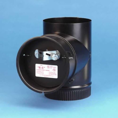

    Let me ask you something about barometric dampers...why the "vertical" "horizontal" slots on the weight adjustment? This would be on a Field RC type baro...see pic.
    Mine is installed in a pipe that is closer to horizontal than vertical, but moving the weight to either the H or V side seemed to make no difference...
