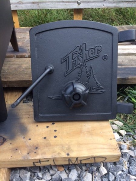

    Honey Bear 1.jpg A blower was available for the bottom rear to blow up the back and out the curl over the top. Stoves were available in Metallic Brown, Satin Black or "Brass and Glass". They also have inserts made of cast iron to close the glass opening in case of breakage.
    Blowers in black and brown as well as cast plates are still in stock. (a shameless plug)

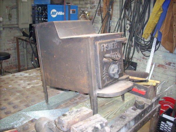

    Here's an older one I restored... The pipe in the back was cracked all the way around it, I re welded it like new. I added some side 1" flat bar of the top so things didn't get knocked off.. :whistle: It had in the past... :p

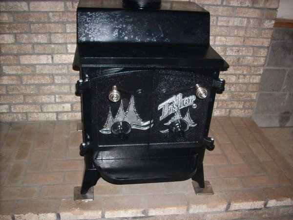

    Yup! That'll do the trick! Very nice! The flat bar idea was because of kids and dogs!!! :picard::hair: Things were getting bumped, toy balls hitting stuff and flying off etc... I put a front lip on my Grandma to help when we cook on her. spillage and stuff... If you look close you'll see it, this is pics right after I refinished her, she was 10 years over due for a face lift.:tears:
