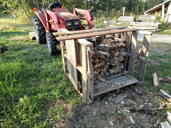

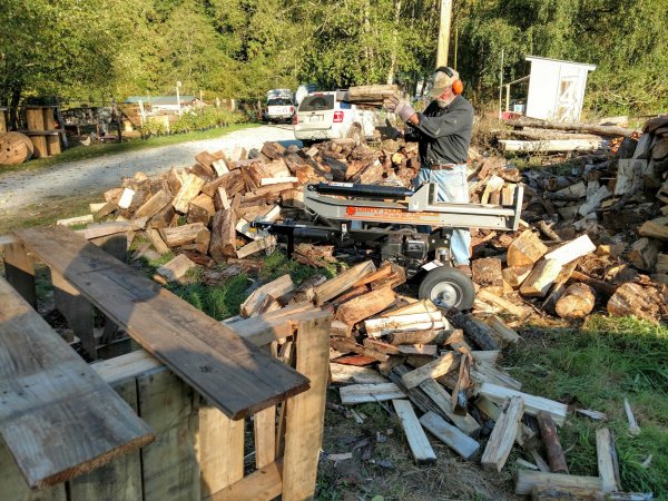

    After 11 years running 100% wood heat, and only a chainsaw, ax and maul I finally convinced the Domestic CEO that a splitter made sense (4-6 cords a year). We also got a tractor this summer and I've fallen in love with pallets for handling everything we have/do here on the farm.
    We knocked together two firewood totes (about 1/2 cord each) so we can now brag about how much we can split in an hour and know exactly how much is in the shed/hoard. I have seen some other pallet tote designs that are better thought out, so I'm sure I'll be tinkering with mine.
    So far the only modification to the splitter was to install a small induction hour meter, so I can know if I need to change the oil (which I do now that I hit 5 hours). The side tray/table was not in stock, so I ordered it and FedEx says it is on my doorstep right now, come on quitting time!
    Thanks to my dad for coming over to help break it in!!

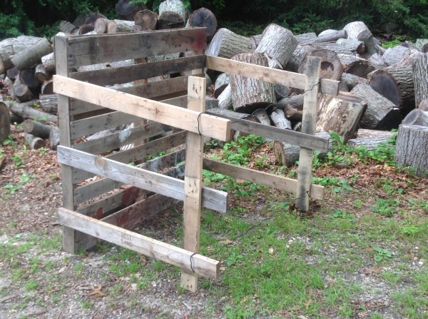

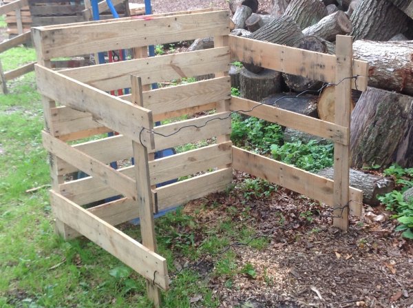

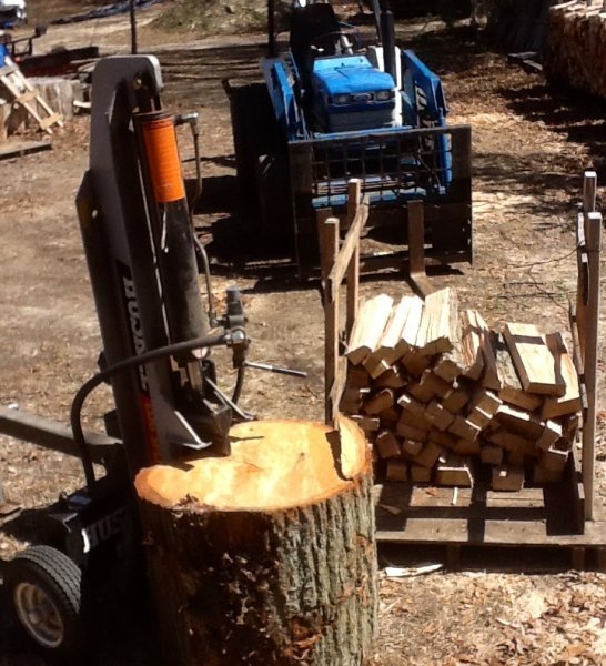

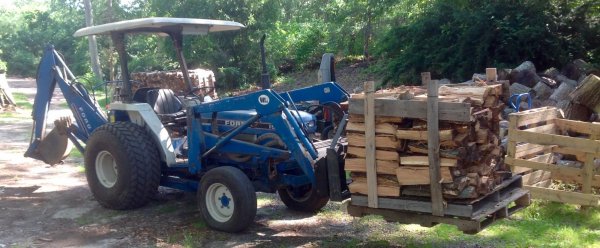

    Glad to see your pallets for wood, congrats on the splitter too
    I've been using pallets for wood for many years. They are the best.
    Think about putting a sacrificial pallet under the one loaded with wood to keep it off of the ground.
    When I split now I put wood directly onto the pallet. Move splitter and fill another etc. Then use tractor to move pallets to storage area. No big pile of splits to stack later!!
    These pics are how I'm making my pallet racks
    All wood is from pallets taken apart
    The empty ones are on their side so I can move them with a hand truck
    You have to look close but there are two strands of wire across each of the uprights.
    Wire is unwoven from black chain link fence. It holds up well and keeps sides from spreading when I'm moving with tractor.
