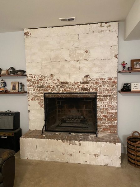

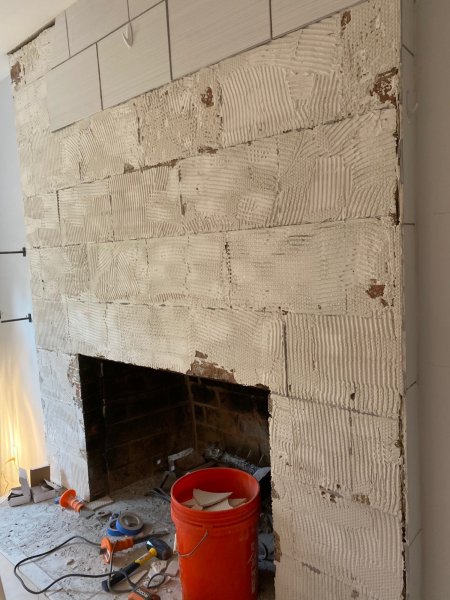

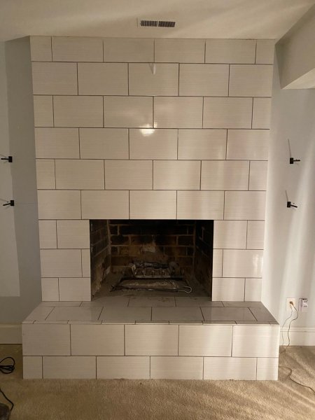

    We bought our first house almost 1 year ago and one of the first things we said when we viewed the house before we bought it was that we suspected there was original brick under the white tile someone slapped onto the fireplace hearth/surround. After looking closer once we moved in, it was obvious they had placed the tile directly over the original brick, so one of our early spring 2021 projects was to rip that tile off to expose the original brick. It is a shame someone ever thought it was a good idea to cover it up, but oh well. Getting the tile popped off was the easy part, I had that done in a weekend - however, the thinset underneath the tile was a bigger issue.
    It took several weeks working after work in the evenings and on weekends to get the thinset off, mostly using a diamond coated wheel on an angle grinder hooked to my shop vac to get the bulk of it off, then went back over the whole surface with a non-woven abrasive wheel on the angle grinder. I setup plastic sheeting between the fireplace area and the rest of the room, had a box fan in the window, and wore a respirator (there was a good bit of dust as you can probably imagine). There are still remnants of the thinset on the brick, but we think it gives it a unique sort of aged look. Originally we had planned to whitewash the brick because of this, but more and more people kept saying it looked good as-is, so we've left it that way.

    Thanks everyone for the kind words. The tile was placed over the brick as part of a renovation in 2016 before the previous owners purchased. I agree with the sentiment that the realtor was going for a more modern, clean look - but not what I would have done.

    A little late since you have a lot of the work done, but needle scalers work great for removing this type of stuff. Good at getting in all the tight spaces.
