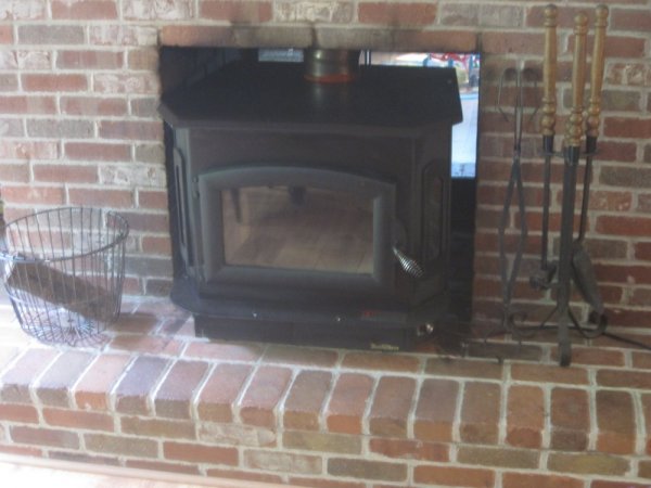

    Here's a picture of my setup. It's a Buck 81 that can be used as either a free standing wood stove or fireplace insert. I has a blower on it:emb: which some people don't like. I have about at 25' chimney and as you can see the existing fireplace was double sided. I installed a stainless insulated flex liner and put roxul around the liner where it enters the clay tile flue. Forgot to do the top but will get it next spring/summer.
    We're using this as our primary heat source (oil forced hot water backup) and it's working out pretty well. Good luck

    I know nothing about that insert but it looks like it has good reviews. You can also consider buying it here:
    http://www.northerntool.com/shop/tools/product_200577755_200577755
    Same stove but $300 less. Depending on your situation, this could be cheaper with tax and shipping depending on whether you require lift gate service or if you can get a discount at Lowes. Looking forward to the pictures.
    If you're going to use a flex liner, getting a good accurate measurement is important. I ended up buying a 30' liner and then cut 5' off of it during installation. Probably could have gotten away with a 25' liner and saved a few bucks.
