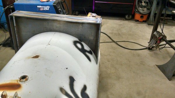

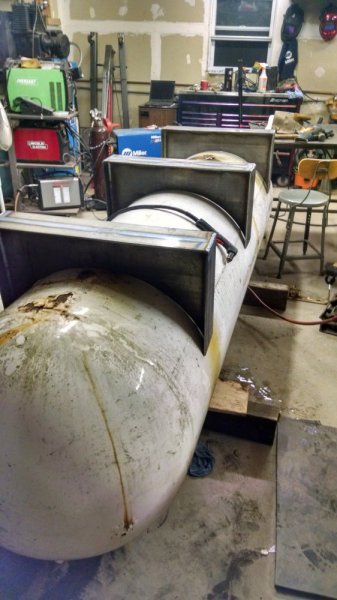

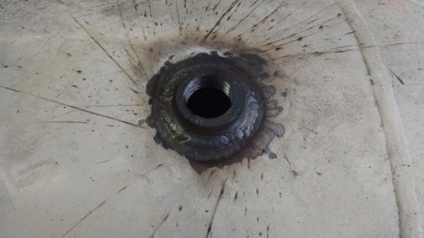

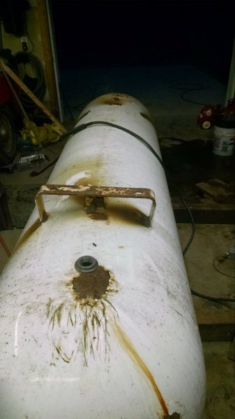

    Added some ports to my first tank today and started making the new stands.

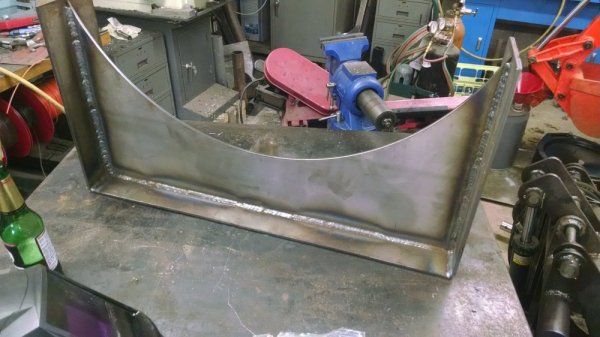

    Off with the old feet.
    On with the new

    Looking good HI. By chance do you have any idea how much that tank weights with the new feet on?
    Whats the next step??
    Pallet Pete likes this.

    I'm guessing it weighs about 650 give or take. It's a 330 gallon tank that started out around 600lbs.
    Next I have to pressure test it to make sure the welds on my ports are good then it's off to clean the second tank that is going on top of that one, add ports, etc. I hope to have the tanks in the house by the end of the month.
