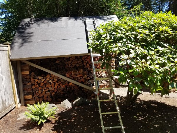

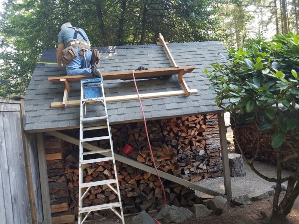

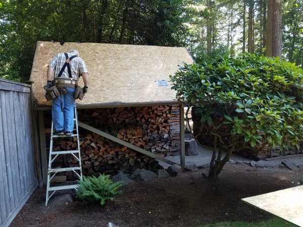

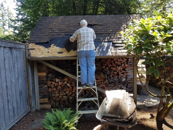

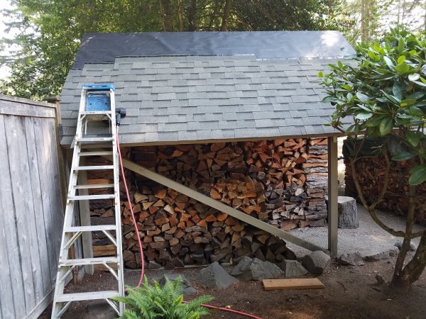

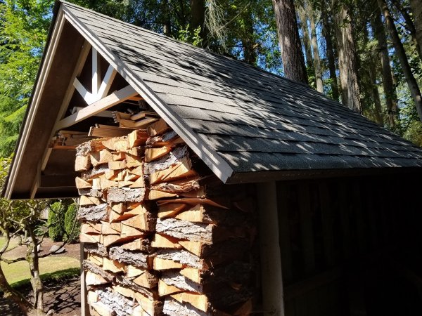

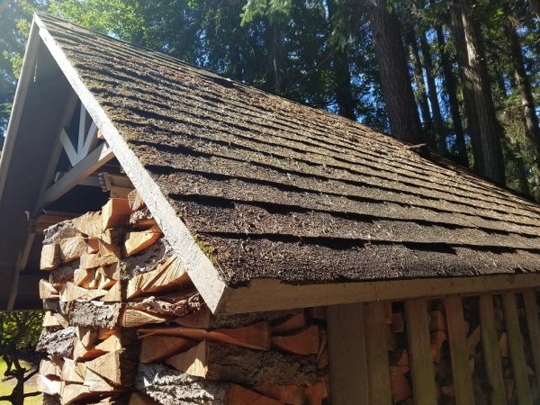

    The day finally arrived. The old roof was 38 years old. Pretty ratty! Only reason it lasted this long was the steep pitch. Wif helped with the tear off, unloading the wheeler into the trailer. Didn't have roof jacks so I made my own plank hanger. Last roof I ever did was...this one as a matter of fact. Had to replace about 6 square feet of OSB on the front side and 8 on the back. Also fabbed up a custom welded SS flashing around the fence post where it meets the roof. Always caught fir needles and rotted the OSB there. Got to buy a new coil nailer. Roofer friend recommended a Max gun but just a little to expensive for one or two time use so I got an Aeropro Hitachi clone for a lot less that the warehouse supply people said was a good cheaper gun. They said a casual user would never wear it out. Worked flawlessly. Anyway, it's done and ready to load the empty side for winter after the coming one. Glad it's over, it was a shock to my system to have to work again! roof11.jpg roof12.jpg roof13.jpg roof14.jpg roof21.jpg roof22.jpg roof24.jpg roof31.jpg roof32.jpg

    Looks good!!!

    Looks Super!!

    Looks great! A job well done. I like your roof jack.

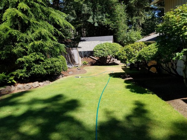

    You did an awesome job! Your backyard is beautiful!

    Great Job Buddy. Wonderful back yard.

    Very nice!:yes: I love dimensional shingles, no waist. Between my back and knees, that would take me 4 days!

    Thanks about the backyard. I have just started my yearly war with the raccoons tearing up the yard to get to the crane fly grubs (I don't poison the yard). Just live trapped one last night and released it on Ft. Lewis out in the woods near coyote central!

    Beautiful place and it looks like you got your monies worth out of the old shingles..

    Turned out awesome!! Really “nailed” it....

    Coming from a former professional roofer (still do some, but small scale, repairs etc.) you did an awesome job and i mean that sincerely! :thumbs: :yes:
    I cant believe you used a nail gun though! Hate the darn things for shingles.

    I only used 7/8" nails because I didn't want a lot of pierce throughs to be seen inside (when empty or partially so). I have battered up my fingers enough without doing it more when starting those short nails with a roofing hammer. Besides, I wanted a new toy! Thanks for the positive report!
