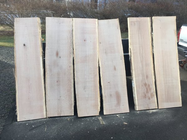

    After months of no cutting I finally got out yesterday and was able to put Granberg Mill through a good test run on some oak. It was a little slow and quite a workout but I am pretty happy with the end result. Eight really nice slabs ( 2 more still in trailer and not shown ) widest just shy of 18 inches wide 1 3/8 thick and 5 foot long.
    There is more where this came from and looking forward to round two soon.

    Nice boards! I don't think most people have any idea just how much work is involved in chainsaw milling. Since you're familiar to woodworking, I'd imagine you know the importance of proper sticker stacking. My learning curve was steep there. I knew what was needed but didn't realize how much apple wood twist, cup and bow. Should have had some cheap wratchet straps. :picard:
    Do you just plan on letting the air dry?

    Yes that was my plan ; unless anyone has any other tips that might be of help.
    Right now they are sticker stacked in my basement and ends have been painted.
    Learning curve for me so any input from others would be appreciated.

    apple wood is some crooked wood to dry oak is usually not to bad to dry JB

    Gorgeous planks. I think you may be better off with them outside rather than inside to get some circulation of fresh dry air, especially for the initial drying process. Also, the fumes that come off of freshly sawn oak are very corrosive. One of my first attempts at drying lumber, I put a big stack of green oak in my pole barn with a fan for about 2 weeks while I was out of town. When I came home, all exposed metal surface on everything in the barn was rusted/hazed from corrosion. Later on, once your board have reached EMC, 12% you can bring them inside +/- dehumidifier to bring them down to final ~8%. I'm no expert, but you can learn from my mistakes.

    Thanks , I was concerned about leaving them out with the weather here. Rain and snow ( although not much snow this year ) and them just not drying. Cant say that this is green so to speak , it has been down for a while before I got to it. I appreciate the input and might have to see about getting them out of the basement?
