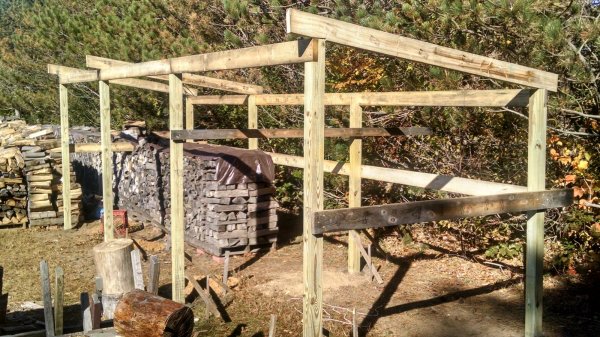

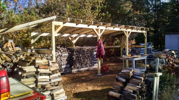

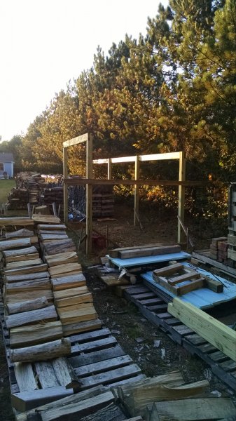

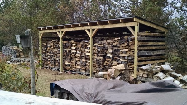

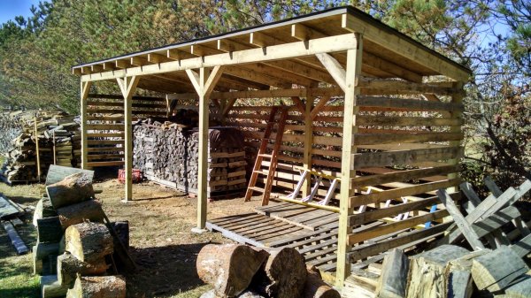

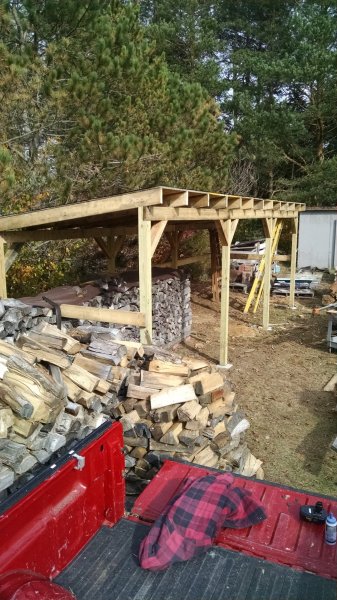

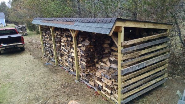

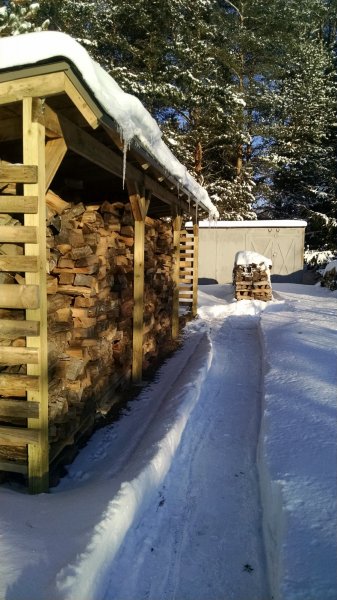

    After scrounging up as much materials as I could and figuring out how to build it around the stacks, I built this. Not being a carpenter or a builder, I pretty much sketched it out and went for it. Everything except the posts and hardware was secondhard as you can see from tthe multicolored shingles. Pallets and shipping crates make up most of it. Floor is pallets set on brick pavers. The shed is 28' wide and holds a littlo over 10 cord if full to the top. I've got about $250 into it, so it did not break the bank. Just kept scrounging stuff till I had enough to startl, IMG_20141007_183647391.jpg IMG_20141009_182441092.jpg IMG_20141011_110316210_HDR.jpg IMG_20141011_110418093_HDR.jpg IMG_20141019_103924909_HDR.jpg
