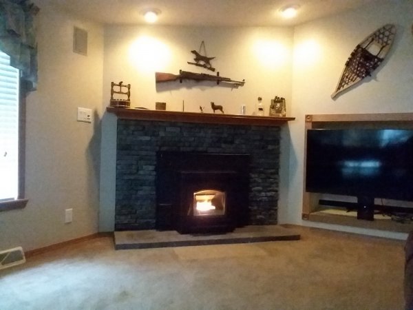

    I finally installed a 35i with a zero clearance box, stub kit ect with the help of the install crew where i work. This is now direct vented with air.
    This replaces an old Englander free standing that vented into an air cooled fireplace.
    Got it at cost plus 30% employee perk.
    I'll get a custom surround from our local metal fab shop. Turned out great!

    Thanks....Kicks some nice heat! Just trying to get the burnoff done with- windows open ect

    So how far up does the pellet vent piping go in the chimley?

  5. Well Seasoned
    18,016
    83,606
    My original Englander vented into the air cooled chimney about 6 feet- did its job but not ideal. This insert is direct vented out the back of the house.

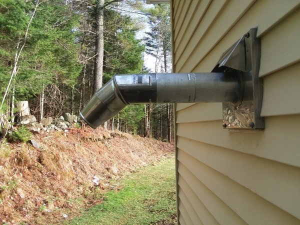

  6. Eric VW
    23,598
    133,373
    Ok, cool. Nice install, very clean! :yes: Is there an OAK penetration out of the picture frame?

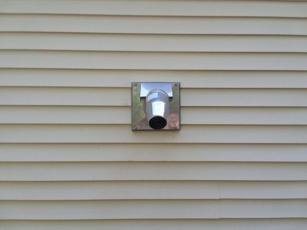

  9. Well Seasoned
    18,016
    83,606
    The outside air is in the direct vent system, draws in at the upper hood in the picture. It's 6ft+ high
    This morning had 5" snow.... already melted
    mat60, ivanhoe, T.Jeff Veal and 8 others like this.

    I was kinda wondering what that hood was for- now I know- that’s awesome!

  13. bogieb
    11,489
    69,741
    Very nice, I'm sure you will be happy with it.
    That is a cool setup for the OAK, never seen one like that before.

  19. bogieb
    11,489
    69,741
    Oh, I have seen them, but never in person. Something about being $100 more than the pass thru I have being an issue at the time.
    What size is the opening for the OAK - 3"?
    Mine is 2" and I would prefer the larger. Hmm, now you got me thinking that maybe, since I'm not stretching pennies, that I should be looking at changing up.
    ivanhoe, MikeInMa, Horkn and 6 others like this.
  20. Well Seasoned
    18,016
    83,606
    3 or 4- it can do either
