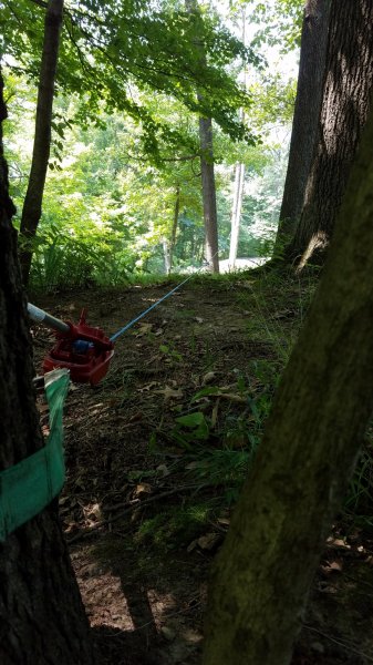

    I use a More Power Puller quite often. I love that thing! You can use it for felling, dragging (short distances, you'll wear yourself out) moving large rocks etc... I've used mine for getting my saw unstuck in the woods also by pulling the tree sideways and reopening the kerf. 20200705_122548.jpg
