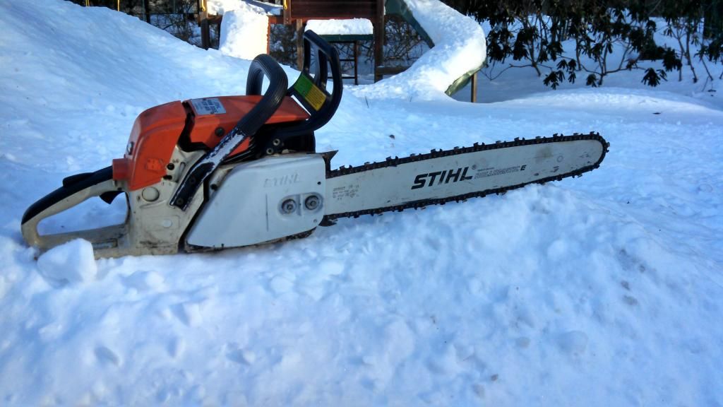

    My 038 Mag got some sweet hand-me-downs thanks to DexterDay and basod during the Christmas giveaway thread. I appreciate it fellas!
    This saw has been a non stop headache since I bought it as a toasted super. But after draining all the other saws I got her ticking once again, new gas cap and found some junk in the carb screen, one turn out on the L and she was running.
    Poser pic on one of the snow mounds... can you tell why I'm draining all the saws?? :hair::wacky::loco: :crazy:

    That chain cover is near pure as the driven snow.
    You could at least write something in the snow - maybe.... STIHLS RULE:D

    Hahahaha yeahhhhh....
    The chain cover I painted with TSC "Light Ford Grey." The previous owner of the scored up Mag version had scratched something in the clutch cover and the front of saw (beneath the muffler.) Both were covered in some black paint or marker that I couldn't just remove. So I scuffed both areas up, cleaned them up, and had at it with some primer and rattle can. Looks better now, but she's no trophy saw that's for sure. 72cc of old school grunt. I set the squish to 0.020" and it it isn't TDC when I pull, I know about it. Can't quote compression as my gauge isn't very accurate.
