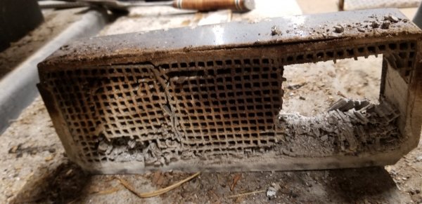

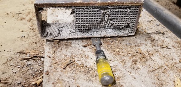

    I've noticed in the past few weeks that things dont seem quite right with the stove. Not making temp and not drafting well. So i pulled the flame shield down and looked at the Cat. Well it was crumbling on the right side. I put the cover back on and decided t o burn the stove down and install a Cat i have on hand that has some damage on it but still serviceable...... So today i had the stove cooled down enought to work on it.
    I started by doing the boiling the cat in 50/50 Vinegar solution..... Once that was over i started by sweeping the chimney, It was really sooty compared to normal. Then i pulled the cat, or what was left of it, it crumbled onto the floor of the stove. and azz soon as i turned it upside down it fell completely apart. See the photos of whats left of it.
    This is the third cat in 6 years, my wood is three years dry and i dont run this thing past m of normal on the stat. Am i doing something else wrong or do the ceramic cats just plain suck.
    Thinking Condar Steelcat for the future, even if it starts to not be active at least it wont crumble and clog the draft????? Do they come out and go back in easily to clean? What maintenance do they require?

    My ceramic cat crumbled after 10 yrs. Replaced this past 4 with condar steel cat. Draft is much better.

    bobdog2o02 welcome back oh, I remember you being a responsible burner, so I will assume it's probably just the ceramic cat. My SS lasted 3.5 years before it death. And looked fine where your pics of cat are beyond dead. A BK princess is a quality stove also..
    Is a SS cat an option?
    I believe stories like this are what gave cats stoves a bad reputation!! Not saying you did anything wrong. Maybe a bad ceramic batch or kiln in supplier?
