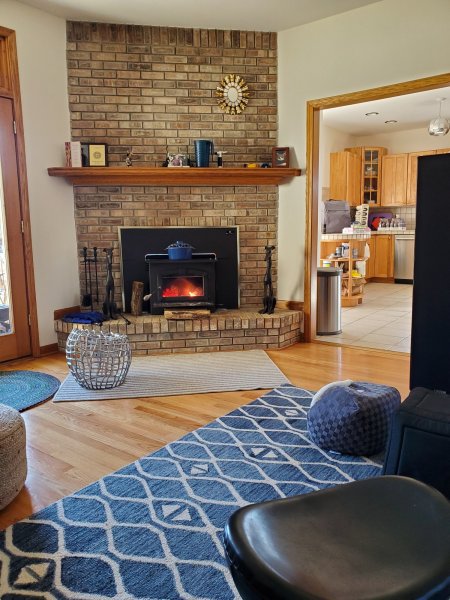

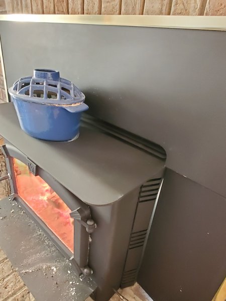

    I recently installed a 6" variable speed brushless dc duct blower into the back of my Breckwell wood insert. I got the Breckwell new old stock last year. It's the old USA made Breckwell. I burn it 24/7 and it has kept my 3800 square foot home warm while using the natural gas furnace less than 1 hour a day on average.
    Since the insert was installed into the opening of a double sided fireplace, I had access to the back of the stove to install a "real" blower. Photos attached.
    My duct blower has 10 speeds, and I almost always keep it on speed 1 or 2. If I go higher I have to open the air more to keep my stove pipe and firebox temperatures hot enough for efficient combustion. And like Winston, I do not see any real increase in heat output from doing so, at least not enough to justify the way it will eat through wood if the air control is not closed down. I think that having to supply more air is taking me out of the optimal air to fuel ratio. And, more of that heat is going up the chimney.
    There is one scenario when I crank the duct blower to high....
    The duct blower is pressurizing the cavity between the stove and the external steel shell of the insert. Most of this air is pushed out of the front of the stove, but it is also pressurizing the air intake. In other words, I am forcing air in the firebox beyond what the chimney draft alone would pull in. But since the higher fan speed pulls more heat from the stove, it seems to keep temperatures in check despite that fact that I am supercharging the fire, so to speak.
    On a few occasions I have loaded up the stove with good dry wood (ash and oak mixed) and turned the blower speed to 10. By doing so, I am forcing a lot of extra air into the firebox, but I am also moving about 600 CFM of air over the top of the stove. The result? My little insert acts like a forced air furnace blowing 600 CFM of hot air out the front. This probably isn't terribly safe, so I have only done it with constant supervision. I can burn through 20 pounds of bone dry oak + ash in about an hour, and I see almost nothing coming out of the chimney, so it is burning efficiently. Doing this, I have taken my large, 2-story home from 60 to 70 degrees in less than an hour, with an outdoor temperature of 20-25 degrees. It heats the house about as fast as my 100,000 btu high efficiency gas furnace.
    So to anyone who has ever wondered if a huge blower would improve the performance of the stove or insert, the answer is --- probably not, unless you have an insert that you want to turn into a wood eating, forced-air monster.

    That’s an awesome idea and setup you did! :salute:
