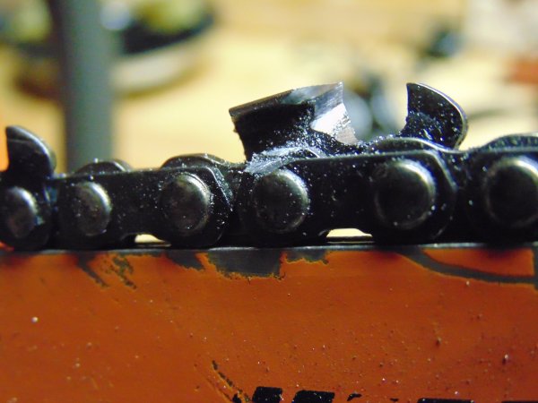

    Wanted to try sharpening a .325 chain on a square Simington grinder.
    Got a lot of negative feedback on another site but I actually think it did a decent job of cutting.

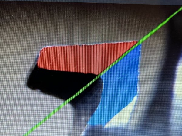

    What I’m not seeing in that chain is the defined line that starts at the working corner. Seen here:

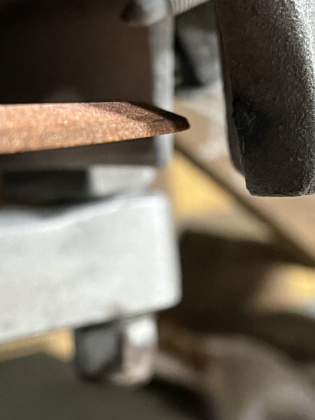

    With .325 I just dress a wheel with very short side plate:

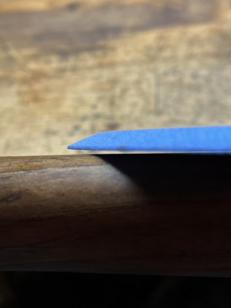

    Reason for the thin dressed wheel, helps keep the tie strap from getting chewed on, like the file did:

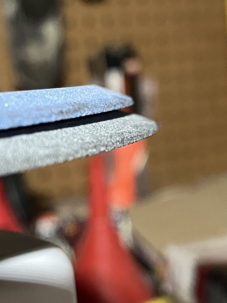

    I don’t change the dresser angles for them, just the thin side on one wheel.
    9F7B8CCD-F003-45C9-88BF-204A2C088577.jpeg D36DFFEA-80BE-4259-BB80-66F74A0EE5B8.jpeg
    (all used for 3/8) and absolutely not out of line.. anytime! :handshake:

    In theory do you get the same result from the different discs if they are dressed the same?

    Wondering if one is preferred over the others?

    Yep. The chain holder position is key as well. Once you get your dresser angles set, it's just a matter of getting that right and you're off to the races.
    The grey wheel is great for converting round to square. Then the salmon and blue are great for maintaining. Those 2 can overheat the tooth if you try to remove a lot of material too quick, but they leave an excellent finish.
