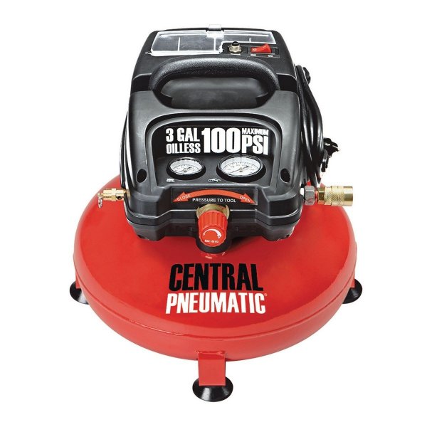

    I'd like to get an air compressor, to clean/blow debris off my saws. I know very little about them. I'd have no other use for it.
    Is something like this going to work for me?
    It's $40.
    Looks like maybe a hose and air-gun is also needed.
    I don't have a true workshop. So small and portable.
    What to avoid also has value.
    Thanks.

    For just blowing off your saws, that unit should work fine...might check the cost of the extended warranty?

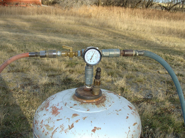

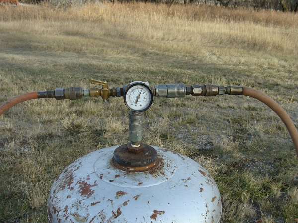

    The weather was pretty cranky for the last few days with well below normal temps and well above normal winds so I didn't get pics until yesterday.
    I'm using an old 100 pound propane tank for an extra reservoir for my 1 horsepower compressor. The compressor's tank is about 10 gallons or 1.33 cubic feet and the 100 lb. tank is about 24 US gallons or 3.2 cubic feet. When you get your tank home remove the propane valve and turn the tank upside down. There might be some liquid condensate left (gasolene for all practical purposes).
    What I've got here is a 1/2" to 3/8" pipe thread reducing bushing, a 3/8" close pipe reducing nipple and a 3/8" Tru-Flate type P female coupler. This connects to a 3/8" Tru-Flate male coupler and a 3/8" pipe tee with pressure gauge. The left inlet side of the tee connects to a 1/4" pipe thread Milton Type M male coupling though a 3/8" to 1/4" bushing. The brass petcock isn't absolutely necessary but it saves air when you disconnect. The tank is filled from the compressor by a 1/4" Milton type M male coupler and a 1/4" air line.
    The outlet side has a 3/8" close pipe nipple to another 3/8" Tru-Flate type P female coupler. Next there's a Tru-Flate 3/8" male to 1/4" male pipe to a Milton type M 1/4" female coupler which connects to a 1/4" hose by a Milton type M male. This 1/4" to 1/4" setup is best for reach rather than volume.

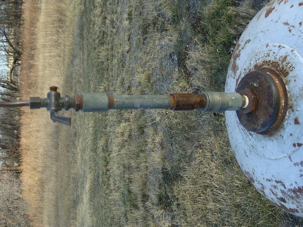

    Next is the 3/8" hose coupled up with the 3/8" male type P coupler with the 3/8" - 1/4" adapter sitting on the tank. Last is my home-made 1/4 blow gun. It moves a lot more air than those store-bought wands, which weren't available 40 years ago anyway. You can bend the copper tubing and get into tight places like between a radiator and fan.
    I drilled and tapped the pipe tee for the pressure gauge myself. Handy but not absolutely necesary. A 1/8" thread hole is easier to tap on a curved surface than a larger hole.
    There's a number of different coupler types. I used what is locally available. You should be able to find 1/4" couplers in most hardware stores. 3/8" are harder to find, but your local tire shop probably can help you. Why is a Tru-Flate a type "P"? It's a Parker design.
    Always cap the tank if you're moving it. Knocking the valve off a 100 psi tank is dammed inconvienient, but every welding class should have the story about knocking the valve off a 3000 psi oxygen tank.

    1st pic - 1/4" line in and out.
    2nd pic - 3/8" line out.
    3rd pic - 3/8" homemade wand.
