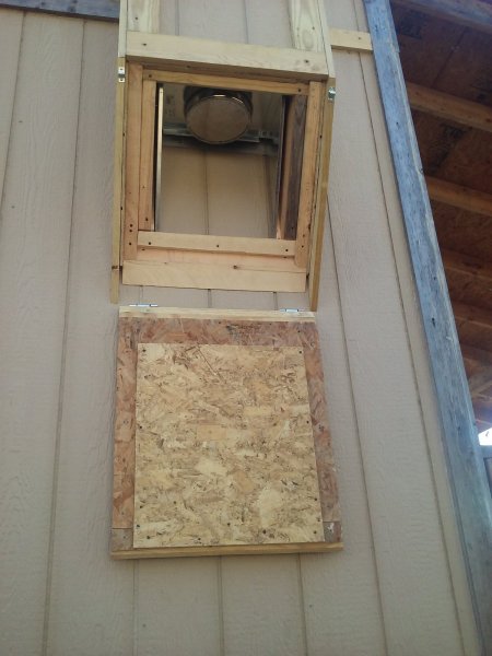

    Chase bottom.

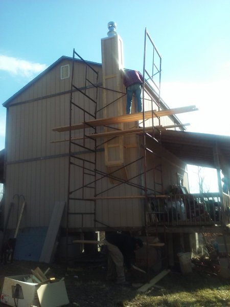

    Chase not quite finished here but you can see that it's tall enough.
