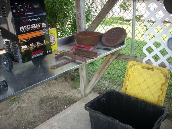

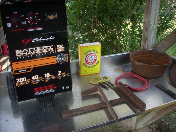

    1st) your gonna need a big type tub as you see in the pics, rigid side, "not a rubber maid soft type"
    2nd) gotta battery charger? A automatic charger "will not work", it has to have a manual setting and hold position. A simple 10 or 20 amp charger works well. Automatics will cycle and shut themselves off. You don't need a big @$$ one like this.

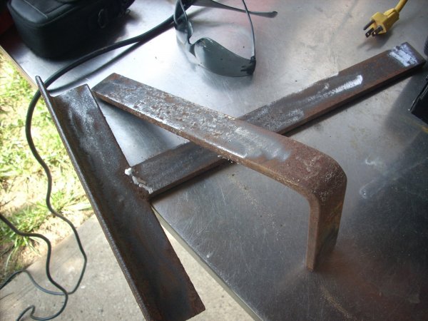

    3rd) any good fairly clean scrap metal, rebar, angle iron, etc... "DON'T" use galvanized. you won't like what happens... It really doesn't need huge pieces but big enough to go to bottom of tub, seems to work better.
    4th) some good heavy wire and clamps.
    5th) Washing soda! Don't matter what brand, most hardware and grocery stores have it.
    6th) Time... don't hurry, it'll work! If you stand there and wait for it to work, you will eventually have to go to bed! :whistle:

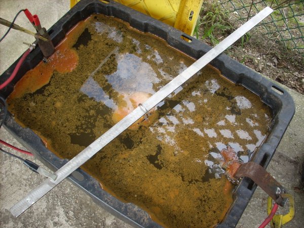

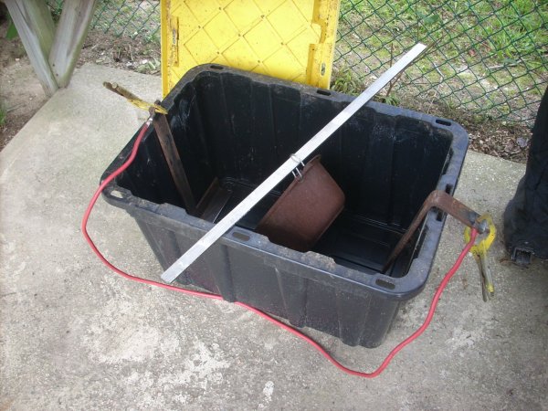

    Start by putting your scrap metal on each side of your tub and clamp a heavy wire to both.
    Add a hefty cup of washing soda to your tub, insert your piece you want clean.
    I happen to hang my pieces from a hunk of stainless flat bar I have, but you can use a piece of wood or basically anything as long as you can clamp you charger wire to the piece and get a circuit.
    Fill the tub with water and stir up the washing soda while it's filling and fill till your piece is covered.
    Next, connect your "Negative" to the piece you want clean.
    and "Positive" to your scrap metal, turn it on and go enjoy a beverage.
    It usually takes 24 to 48 hours, "sometimes longer" depending on how bad your pan or whatever is. This pot I'm doing will take two maybe three days.

    It's been three hours since I put the pot in, you can see how nasty the water is getting. I found my smaller charger so I swapped it out from the big one. the big one was a bit over kill and you can only get so much current anyway, The smaller charger is perfect. DSCN2619.JPG DSCN2618.JPG DSCN2620.JPG
