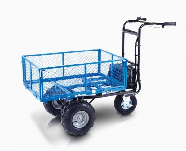

    For years I've been using a Gorilla Cart to haul wood out from the forest around my house.
    (I'm selectively removing dead and hanging trees.)
    The terrain around here has some hills and I'm getting tired of pulling several hundred pounds of logs up the various small logging trails I've been using.
    Does anyone have any experience with these electric carts like the one pictured below?
    I like the fact that it is small enough to get between trees and its quiet, and yeah I'll work the heck out of it since I harvest about 5 to 6 cords a year. Do you think I'll break it?
    I've seen the gas powered 4x4 Yardmax ones but they are out of my budget right now...
    Thank you in advance.

    There are options .....
    Eltschinger Industries makes one powered by an Echo engine ... Little Helper Cart | PaulHaul
    Don't know that I'd trust the battery one. Looks a bit on the lightweight side.

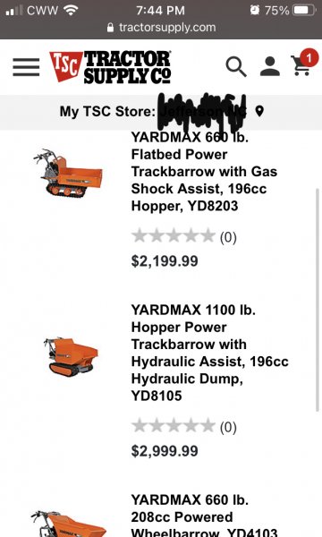

    I'd love to have one of those Yardmax machines...
    If they were half the price.
    Right now I'm looking for a (very) used ATV for under $1K.
    I'm a pretty good mechanic and fabricator, so maybe I can work something out.

    Has anyone ever looked at or tried a concrete buggy? Even a used one is out of my price range but they look like they should be the ultimate. Power dump, easily handle the weight of a full load of even fresh cut green wood.
