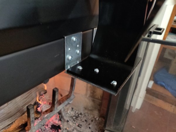

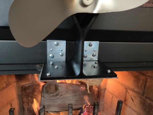

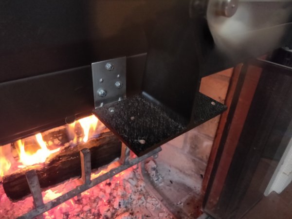

    Here's the bracket I used from home depot. I just used some self tapping screws (zippies) and predilled a hole in the ecofan. Then I secured the bracket first to the fireplace surround and used some short machined screws and nuts to secure the ecofan to the bracket.
    There are 3 screws per bracket screwed into the fireplace surround and one screw on each bracket to secure the ecofan to the bracket.
    These pics are from the first attempt where I added an extra thin piece of metal. That actually prevented the heat from transferring properly. It basically blocked it from reaching the ecofan. Once I removed that plate then the ecofan started spinning super fast.
    An example of thinking I needed to secure the front edge of the ecofan when in fact the one screw on each bracket is more than enough.
    I will say that if you have small children this installation may pose a bit of a risk since the edges of the ecofan are super sharp. You can grind the corners round I suppose. Easy fix. I will do that.

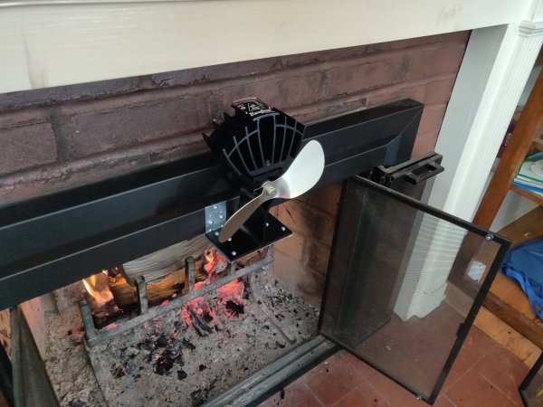

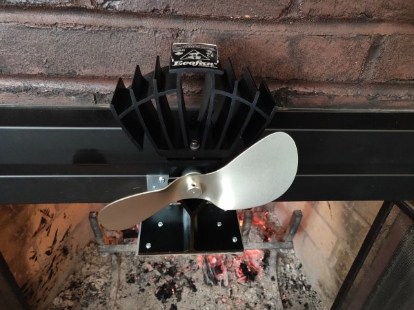

    I just took these pics now. As you can see no plate just the brackets and the ecofan and one screw on each side.
