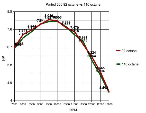

    This was a dyno test, by Chad, showing 92 non-E vs 110 Sunoco racing fuel in my ported 660. My saw is over 200 psi and the dyno didn't show an increase in HP with the 110. The limited amount of cutting I've done with 93 vs 110 the 110 octane was slightly faster by about 10%. But I think the dyno graph speaks for itself. The fuel mix was a 32:1 ratio.
