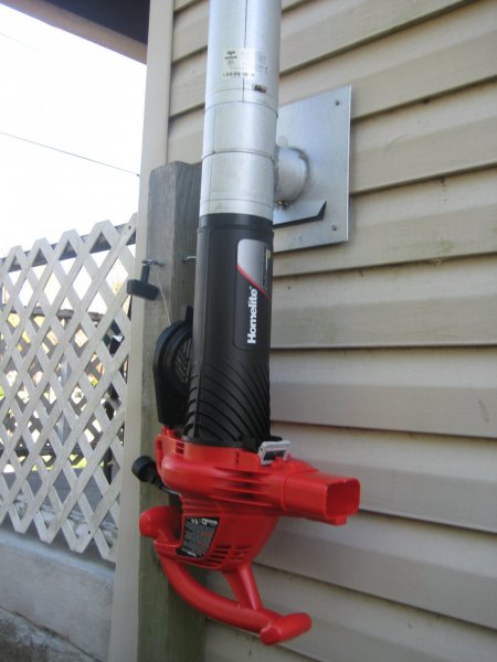

    ya know how when you do the Leaf blower trick and with some setups you put a big rag in the vertical exhaust pipe so you can suck crud from the horizonal tunnel of the OAK intake?
    then you pull that same rag and stuff up the previous OAK entry and now suck the crud from the vertical pipe?

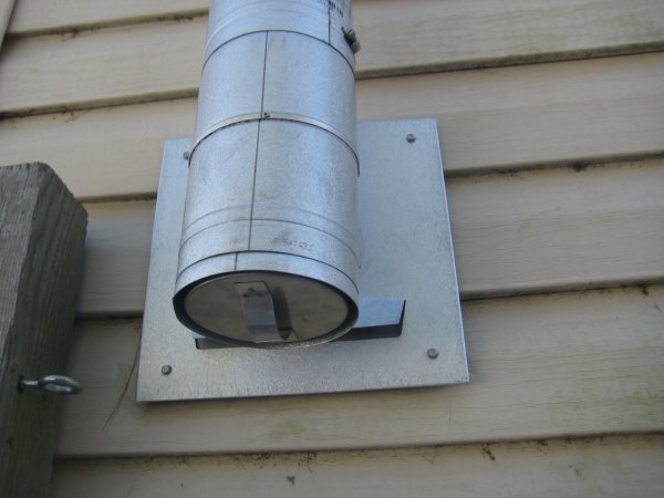

    yep.... soon as i went outside and opened up the bottom cap there she was sitting where i left it in the spring.
    all is well.. lesson learned. stove combustion get's all kinds of confused when you plug it up with a rag.
