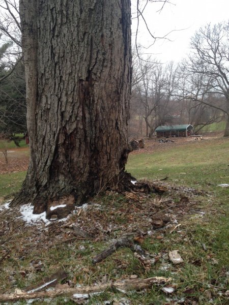

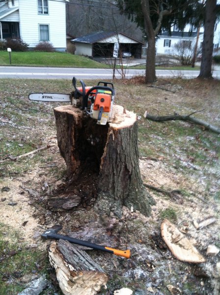

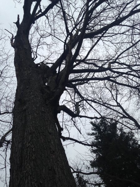

    I have two maples in my yard that I've been needing to drop. The worse of the two came down today. Had a very rotten base and I was worried about it coming down on its own. So today I put it on the ground.
    I knew it had a chance of kicking to the side but it wouldn't reach the neighbors house so not a big deal if it did. After setting a high notch to miss the bad spot I did a plunge cut and set the hinge then out two wedges in before cutting the holding wood in the back. Problem though was the wood under the hinge on one side let loose and threw a chunk from the right side of the hinge about 15'. Tree went to the left. It still landed ok. It had the weight going in the right direction so I knew it wouldn't come back but didn't really want it to go left.
    In the end it ended up on the ground, nothing hurt or destroyed. Just closer to the neighbors then I wanted it to go. I got the main trunk cut into logs and moved all of those and the big branches down to the cutting area so I can work on getting them bucked up.

    Well done man.. That looked ugly before I saw the inside..

    Wow, that sure was rotten. Glad it made it to the ground without taking out anything important on the way. Any time that happens, is a success in my book :D

    Really good drop! With all that rot it sure could have gone bad. Still looks like you may get a fair amount though.

    Trees rotted at the bottom like that can be tricky. I have done a few but nothing that big.
    I say good job with using the plunge cut and you got it down safely.

    Good job taking that thing down. Even before seeing the insides, that tree looked like a trickster. Myself, I woulda called on a pro to drop it. A man's gotta know his limitations - applies to me for that weak of a tree.

    Some really weird growth in that tree Sean. Looks like there are a couple more, or is that some ice/wind damage up top?
