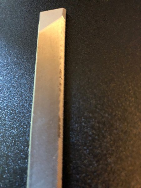

    I ordered two of those Bahco files from Abolox to try. I'm keeping one and the other is for the nephew who wanted to learn square filing. He caught on real quick and did a nice job. I'm pretty sure he is now a convert.
    Anyway, one of the Bahco files that came was not quite up to snuff. The one I gave him seems fine but the one I used is chipping all apart. The first pic has the Bahco on the right. It was used to sharpen 3 chains and it is falling apart. Heat treatment must have gotten botched on this one. Just my luck, if there's a bad one in the barrel, I seem to find it. I even clean the gullet out and way back under with several strokes of a small round file first so the double bevel has less work to do and is easier to keep in the corner and control while filing.
    The file on the left is one I picked up from fleabay last winter and was advertised as a vallorbe or equivalent. Does anyone know what brand uses the horse in a hoop logo? I'm not sure what it is but I have used that file all year and it still cuts like new. It has converted at least 4 chains from round to square and sharpened at least 20-30 loops on top of that. I'm liking it whatever it is.
    Both edges, both sides are just not holding up.
    Sorry for the crappy picture, but it's a crappy file... It does still work, some... but cheez!!
  12. The Wood Wolverine
    15,812
    97,576
    That just sucks. The ones I’ve used look like that after heavy use. PM me your address and I’ll send ya one of my spares.
    I usually use them in cycles, so for converting round to square, I’d swipe with my oldest file a time or three, then I’d switch to a better condition one. Then for the last stroke or two, I’d use an almost new one for a nice finish. It was my way to get the most miles per file.

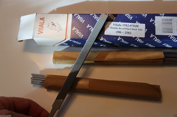

    Just for clarity Cold Trigger Finger I'm guessing you meant Vialla?
    I've personally found the Vallorbe to be superior. As have a bunch of other square filers over on the other forum.
