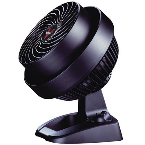

    The space for a fan is why we used this:
    Very short blades and just about silent running on low but is amazing how it can move the warm to the rear of the house.

  14. wildwest
    28,162
    128,145
    Wyoming high plains
    I have a couple of those, they work great, the Vornado I had previously was a lot quieter but it's a big price difference.
