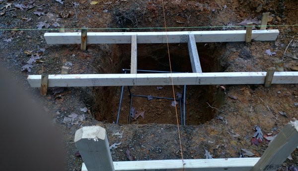

    Here is a hole for the footings, there are 6 total, 3' square 2.5' deep with rebar.

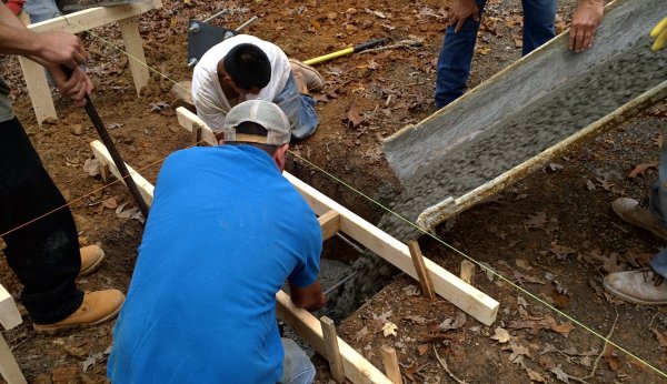

    Pouring the concrete. Almost a cubic yard in each hole.

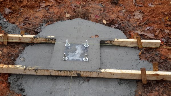

    Footings with anchor bolts.

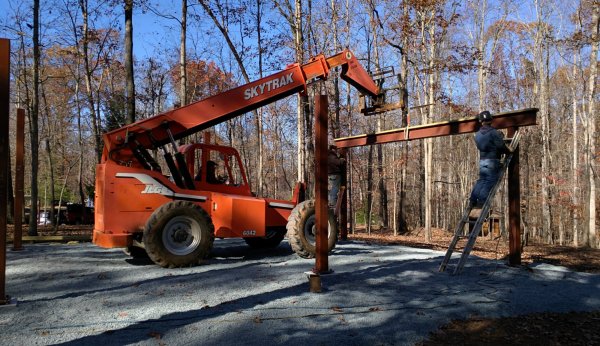

    Beams going on posts. They are 10" I-beams with a "nailer" bolted on top.

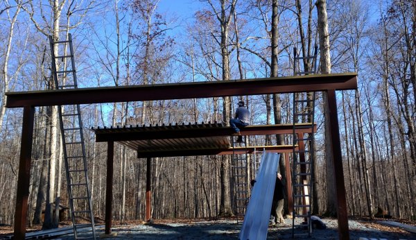

    Roof being installed. It's a structural roof that does not need joists. Spans are 14'. It is screwed to the wood nailers with a whole lot of screws.

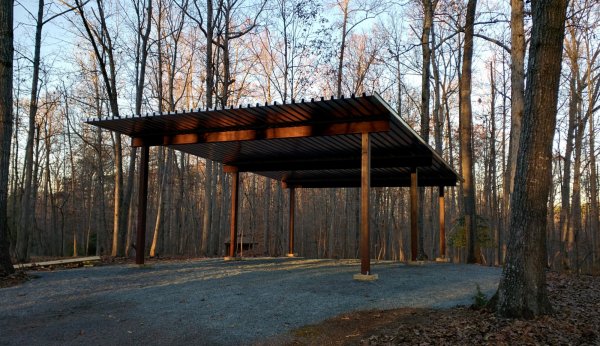

    Finished. 24' wide x 37' deep. You overhang proponents will be proud . . . 5' overhang at front and 4' overhang at rear.
    I use it as a dry and shaded outdoor work place, keep my splitter under there, with piles of rounds and stacked split wood. It's also very near my firepit, so I keep some pit wood dry too. Also have a picnic table there for resting and relaxing.
