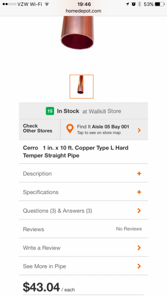

    That's the incoming line, thems the fittings and valves I already have, etc...
    3/4" is commonly the biggest you will find on most well systems. And with most appliances being fed by 3/8" line, you would need a fair number of taps running simultaneously to see a noticeable pressure drop. Theoretically that number is 4. Never tried a practical test.... hmm.
    No Menards within reasonable distance of me! (12566). But that's ok, HD only wants $27 a stick for 3/4"!!
