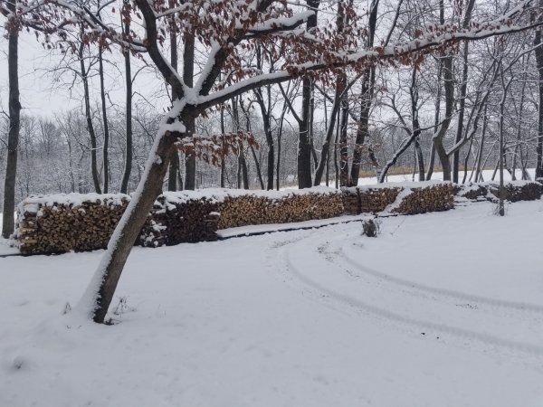

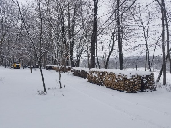

    20221116_111618.jpg 20221116_111751.jpg I typically stack in two rows of pallets, two pallets deep with a gap between the front and back pallet rows. Pallets have 3 rows of splits each on them with a little overhang in the gap. I leave uncovered the first year (3-4 year rotation). This is what I processed in 2022 with pallets sorted by species (different drying times). I have pretty good airflow.
