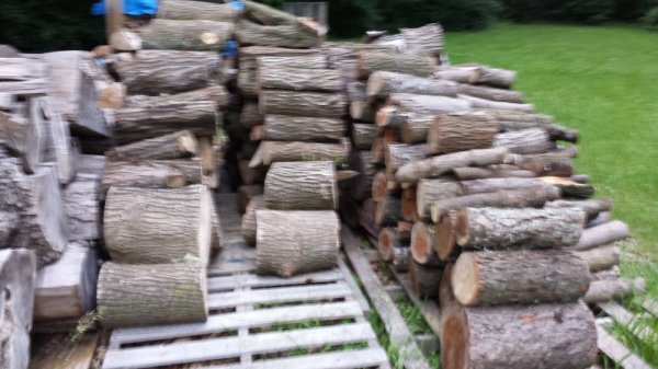

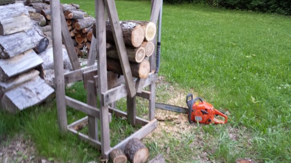

    This is a pain in the azz some pieces are only a couple inches to long but it's got to be done , either they fit in the stove or they don't.
    Got these all cut though , do it all again on the next scrounge :saw:
    Man it was muggy 70% H and no wind

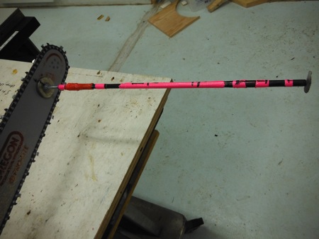

    Yup, been there..... im really going to focus on better measurements from here on out. It takes enough time already to css. Check out Bogy Daves sig..... he has a link to his measurement tool added to his bar. Good stuff!

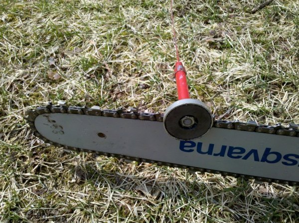

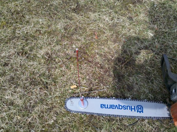

    I use this when buckin logs , EDIT: Made from an antenna
    3780-91d99b3dde5f75e760a57dd3fcacb8dd.jpg 3782-e39db94c87f3c88c135ae967f94d437d.jpg

    Is from a 2 meter ham antenna I got a bunch in a grab box , that's only the top of it , the bottom parts are fiberglass I use to make Bicycle and ORV flags
    They look like a CB fire stick with a tunable whip on top

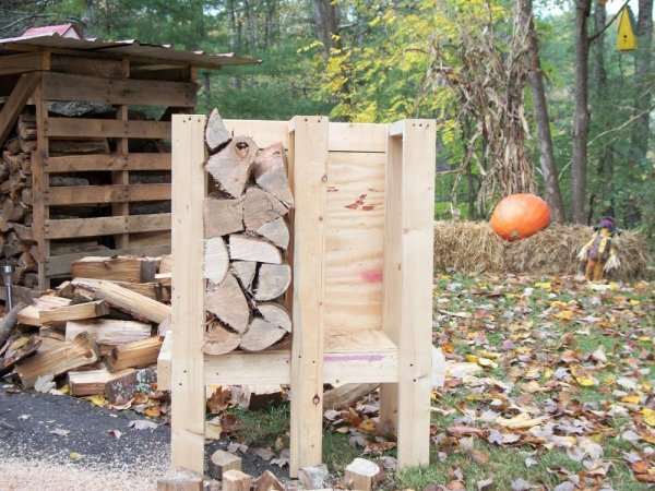

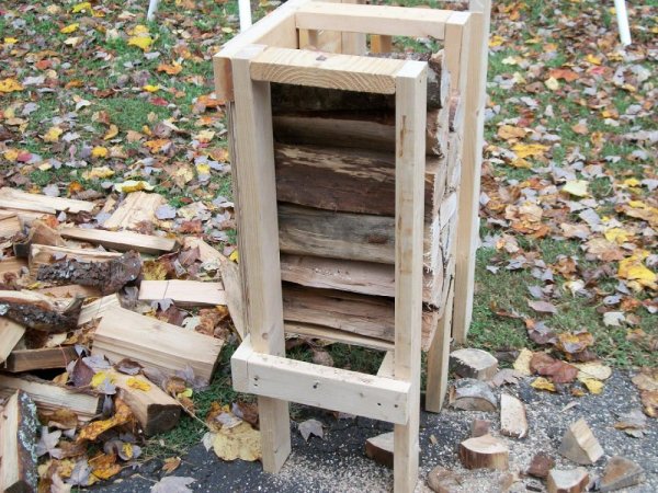

    I would cut them down to 18
    Actually the cut offs, chunky monkeys I call em, work really good for shoulder season
    Its easier if you make up something you can stack a bunch of pieces in and cut em all at once like the rack I made or one like Petes
    How I resize firewood to fit the stove. ( video )

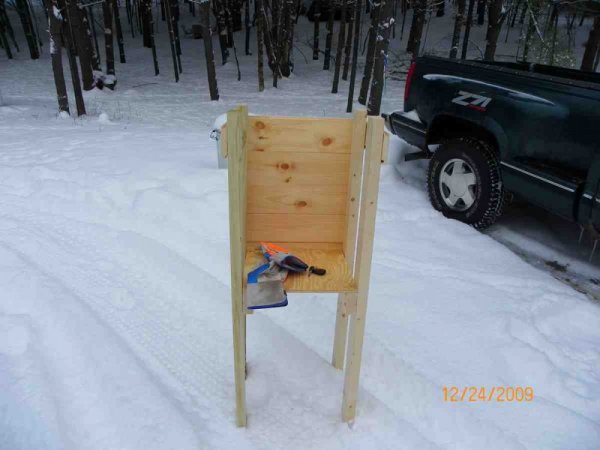

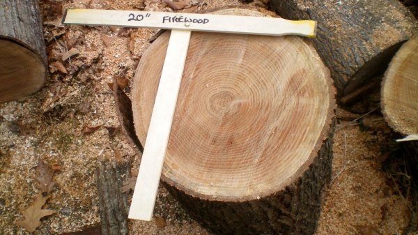

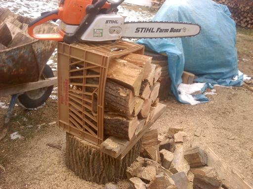

    Doesn't have to be an elaborate jig,
    Some more ideas
    This is zaps jig pic
