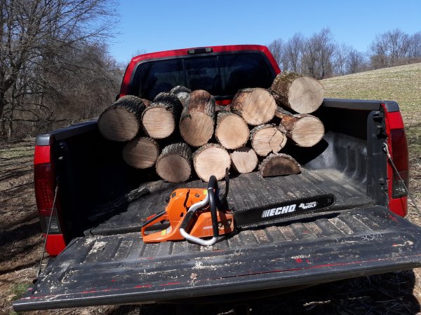

  6. James Miller
    James Miller
    May 16, 2019
    562
    4,005
    Hanover PA
    20210321_122718.jpg I just did the full wrap on mine last week. May need to look into the bigger spikes as the stock ones are about useless.

  12. Lastmohecken
