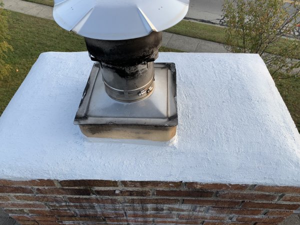

    Took advantage of the nice weather of late. Got a pail of crown coat @ Menards. 10 minute job A6348666-CB42-48BC-AE7C-60F280D3795C.jpeg

  2. ReelFaster
    ReelFaster
    Dec 1, 2016
    2,348
    16,182
    S.Jersey
    Looking great! I really really need to do this. I may do it this year if I get nice weather when I hang the xmas lights

  4. blujacket
    blujacket
    543
    1,907
    Kettering, OH
    Thanks guys. A friend and I rebuilt the crown about ten years ago. I was on the roof a few weeks back and noticed some cracks. I didn't want to have to haul buckets of concrete two stories again. Was excited when I found this @ Menards. Should be good for a couple years, and I'll recoat it.

  10. Locust Post
    8,201
    45,613
    Nice job. I used the Chimney RX brand, trowelable to redo mine last year.
    Horkn and blujacket like this.
  11. blacktail
    blacktail
    Mar 4, 2015
    1,392
    9,445
    PNW
    I used the same stuff. Just checked my Amazon account and I ordered it in August of 2019. Still looks good.
