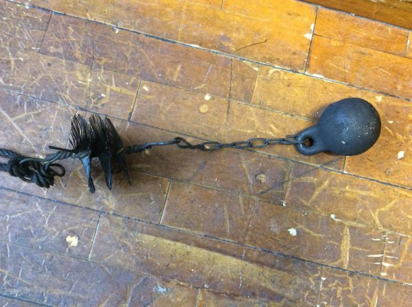

    AF705EEF-DB48-4A1C-B4D7-5AAAB1A29FA1.jpeg 75633248-2288-4F7D-9CEE-8540259A55AD.jpeg hej hej all,
    Today it is cleaning time again, i try to clean the pipes 4times a year. Now i got a total of 6 pipes in my house and i got 5 wood stoves (one pipe is vetilation) and it is always a nice job to get everything cleaned out again.
    Now i got a question about creosote, is there a way to clean this hard stuff out the easy way? Say for instance i burn my woodstove the night before so the flu is warm, do u get the creosote out more easy? I use a metal scraper with a heavy ball on the end. But i have seen these systems with a brush u can hook up to a drill and go at it from inside the house.
    What are the best brushes to hook up on these systems , metal ( wont it damage the pipe from inside) or just a softer plastic brush?
    Please give me some feedback on the systems u guys think is best.
    Have a nice day all!

    The best way to get creosote out it to not put it in! Very dry wood should take care of that problem but sometimes it also can be the fault of the stove. I remember those days of cleaning 4 times every year and don't like it. Now it is a quick brush maybe every other year and then it is mostly fly ash we get.

    Any appropriately sized chimney brush and rods will take care of that. The Sooteater (drill thing) will too. Pretty much anything other that that system you have now :)

    I have a 6" poly brush with rods of appropriate size which works well for my nice straight pipes .
    For offsets a sooteater probably is best.
    I have a square metal brush around here someplace that was used for the previous square masonry chimney. I have a round metal brush for 8" pipe that I don't know the history of.
    +1 with not creating creosote in the first place. Well seasoned wood and don't choke the fire temp down too far. A thermometer with clean burning zones on it goes a long way to a cleaner chimney at the end of the year.

    Note, it was on a masonry chimney not pipe, but we borrowed an attachment that had chains on it instead of bristles that attached to rods and drill. A couple decades ago a man told me to hang a towing chain down our pipe and shake the heck out of it. I didn't understand at the time because I had only seen flyash, but I wonder if something like that only different might work?

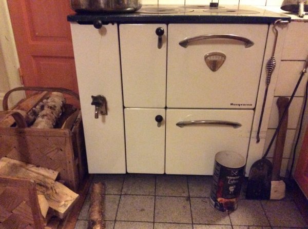

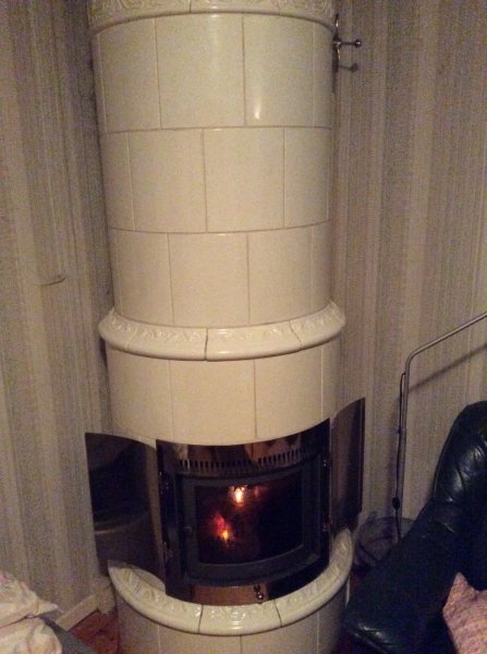

    Hej hej all,
    I live in house with 3 wood stoves, one inthe kitchen (husqvarna), one in my sleeping room (jotul), one in the living room(kaklugn)
    And attached to my house is an old school (my work shop) there also 2 stoves a jotul and also an kaklugn.
    I only burn the kaklugn in the living room witch pretty much warms the whole house, and when i need to cook my kitchen stove is lith, the ones in the old school i only light when i need to be working there.
    Have a nice day all

    That round tile stove is AWESOME.

    The Husqvarna cook stove is neat as well.....never knew they made anything like that.

    6 in round poly brush here, that thing with the chaines on it looks like a great way to wreck a chimney.

    Years ago my father used to use a chain to knock the soot out, but now we all have brushes and it works better I think.
