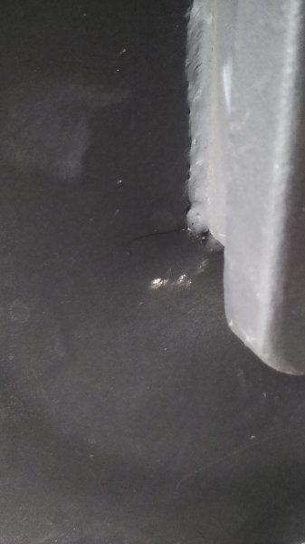

    I have a Fire Chief wood stove that heats my house. I was looking it over tonight and I found a crack starting from the lower left corner of the furnace door. The furnace and door flange are welded plate steel and the crack starts from the root of the weld at the corner of the door flange. I know the stove has gotten very hot a few times when others have left the lower ash door open.
    High heat, under cut weld root, a corner and thermal cycling has cracked my furnace.
    I think it's okay to burn in still. To fix it I plan on drilling out the tip of the crack, grinding the crack, and welding it up. I'm open to opinions and thoughts. IMG_20210110_004705191.jpg

    Sounds like you have the best plan figured out.

    Sounds like a reasonable plan...what model is it? The newer ones have a bad reputation.
    I had a first gen Drolet Tundra...the model that always cracked...I bought it that way, ran it that way...finally fixed it right before I sold it. :picard: Good news is that the new owner says that it has been fine and is very happy with it. :yes:

    I don't know it's exact age. It is not a current EPA model. It's the older design with a simple reburn shelf that can be bypassed to increase startup draft. I'd say it's around 8 years old, maybe older.

    Good.
    Should be fine drilling/grinding/welding then.

    If it’s a hairline crack and not leaking air consider just leaving it. Mark the end and see if it propagates. Our Nashua cracked over 40 years ago and nothing more since.
    If you do weld it peen it really well to relieve tension and maybe even again when it is up to temp.
