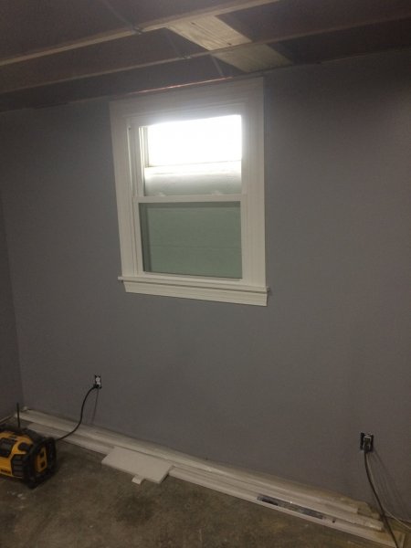

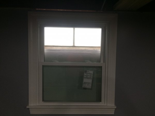

    this is how I finish basement windows, I install a vinyl replacement window in front of the basement window so you get natural light in and when you look at it your brain thinks it is on the main floor instead of the basement. After it was all trimmed in you do not think you are in a basement.

    Never seen that window idea before. Very cool! I’ll be looking forward to the soffit ceiling pics. We just pulled down our drop ceiling in the finished part of our basement because it had been such a crappy install by the previous owners (it only took us 15 years). We were going to just paint the joists and all white. But that soffit idea sounds interesting.

    Love the window idea, will have to remember that one. Turquoise appliances? Can't wait to see it finished.

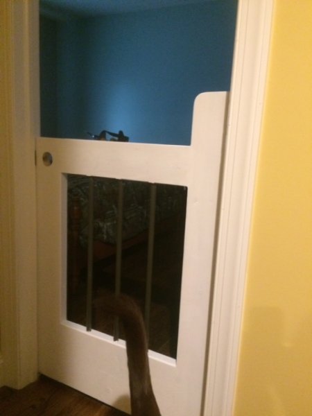

    here is Lucy's new door to her room. We want her to stay home but not in a crate and a baby gate just does not work for me so I built a new dutch door with spindles on the bottom. We shall give it a try this weekend and see how she does.The right side is taller to pick up the hinge I did not want to move the hinge in the frame and the aluminum spindles I had were this length so I made it work.

    I like that idea! We are thinking about the "pet logistics" in our new house...it gets complicated with 5 hounds and 2 cats. We burn in the basement and I'd like to confine the hounds to the basement out of a crate during the day and the cats need acces to the basement all the time for the litter.
